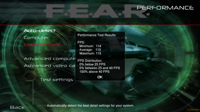

FEAR 1.08 integrated benchmark crashes after the first combat scene @2560x1440.
The game itself suggests that the possible issue is the VRAM (->4096 MB) for that resolution
https://postimg.cc/56rnGdC4

Works fine here with the default (256 MB) VRAM setting. Try copying dgVoodoo.conf from the dgVoodoo archive to the game directory to make sure you're using stock settings.

Resolution? Got the problem at the specific resolution of 2560x1440.

Nope
There's an error in RAM quantity detection, just like in Outbreak.
The same using DXVK 1.8.1
Game freshly installed and manually patched to 1.08.
No issues with MS d3d9.dll

I confim the crash with the lastest WIP
No crash with DXVK or MS d3d9.dll

I know, I already reported that, but what I meant was, the benchmark does not crash under dgVoodoo. There's something else that's causing it to crash.

I have FEAR version 1.8.282.0 and I can't reproduce the crash either. Resolution is set to 2560x1440.
I tested the game through the D3D11/12 SDK debug layer which reported a bug but that only affected forced MSAA case, and I fixed it in WIP79_1.
Tested on both nVidia and Intel UHD.
Also, I found a D3D12 pipeline cache bug but that's D3D12 only, I don't believe those bugs have to do sg to the crash.
So, plz try it again with WIP79_1, and if it still crashes (probably will) then I have no idea (and AMD card).
Also, you can check out the game with the dgV debug layer to see if the crash is caused by a failed resource allocation or sg like that.
