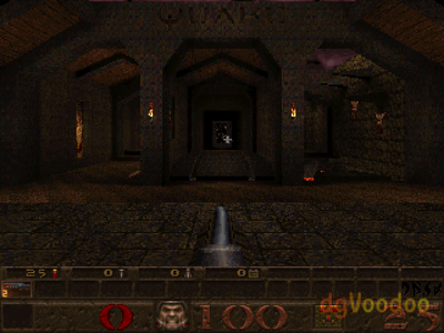

WinQuake a official port of Quake for Windows, without dgVoodoo have 320x240 fullscreen esolution, with dgVoodoo it lacks of 320x240, can you add fullscreen 320x240 for WinQuake back please.

You can add 320x240 as an extra resolution through option DirectxExt\ExtraEnumeratedResolutions.
Reply 3 of 10, by RaVeN-05
Doesnot work, dgvoodoo doesnot report 320x240 as available resolution for winquake, winquake is ddraw , abd without dgvoodoo i can go to screen resolution in game aned choose fullscreen 320x240, when i use dgvoodoo i can only set 320x200 fullscreen resolution

Reply 6 of 10, by ZellSF
Interestingly it does the same thing Hexen II does. If you set 320x240 it pixel doubles internally to 640x480. So that's not a Raven special feature. Like Hexen II you can force that back down to 320x240 in dgVoodoo without problems if you want to use different scaling options:

Reply 8 of 10, by ZellSF
I've already said what settings you need to change? Default enumerated resolutions needs to be set to none, extra resolutions needs to have 320x240. Resolution needs to be set to 320x240 in the DirectX tab. Other than that, the screenshot is just integer scale factor (in GeneralExt) set to max available.
