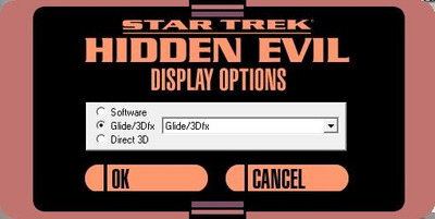

This is a weird problem, I play Hidden Evil fine in Windows7 and 10 but Windows 11 will crash after select Glide and click OK.
How to reproduce (using retail version)
1.Install game with CD-ROM, don't install QuickTime.[*]
2.Find a no-cd exe on internet to replace HiddenEvil.exe
3.Extract QuickTime.qts from QuickTime.zip to Game folder\bin.
4.Copy Glide2x.dll, dgVoodooCpl.exe, dgVoodoo.conf, d3dcompiler_47.dll to bin folder.
5.Right click HiddenEvil.exe and set compatibility mode to Windows98/Me.
6.Start HiddenEvil.exe, select Glide/3DFX and click OK.
In Windows 7 and 10, the game should run fine. But in Windows 11 it will crash.
In debugview there is a warning claiming it requires d3dcompiler_47.dll or d3dcompiler_43.dll but none exists.
Software mode works for Windows 11 so the game is still playable. But I can't understand why it can't find my dll.

Reply 4 of 6, by yochenhsieh
Right. It still crashed if I remove that dll from game folder, dll is not the problem.
The game at starup will let you select which driver to use (software/glide/direct3d)
21.66 KiB
1227 views
So... there are a lot of combinations 🤣
Windows 11 - intel HD 520:
Software, no dgvoodoo - works
Direct3D, no dgvoodoo - works. A big surprise because I never get native d3d of this game to work since XP... In Windows 10 (AMD Radeon HD8250), only 2D part will render but no 3D so you won't see any characters and moving objects.
Glide - dgvoodoo2.78 - Warp - works.
Glide - dgvoodoo2.78 - D3D11/12 - crash after select glide and click OK.
Direct3D - dgvoodoo2.78 - Warp - works.
Direct3D - dgvoodoo2.78 -D3D11/12 - the display option window won't show.
