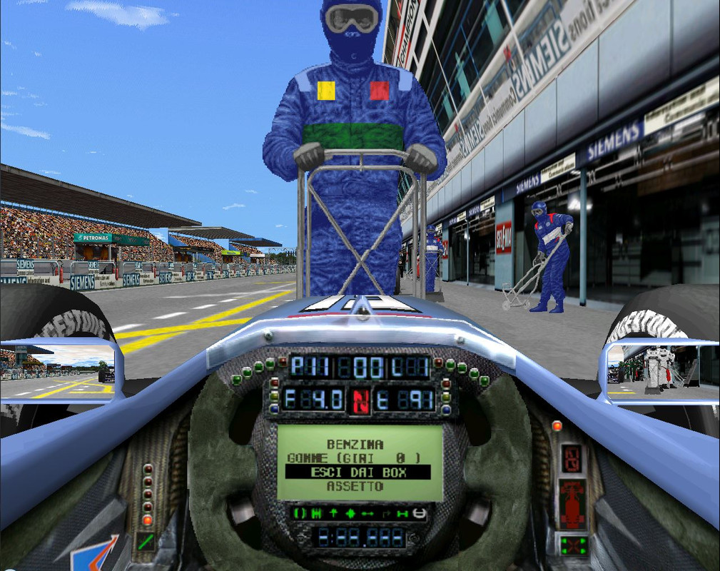

GP3 without dgVoodoo2:
It's a mess but fonts on LCD panel looks as they should.

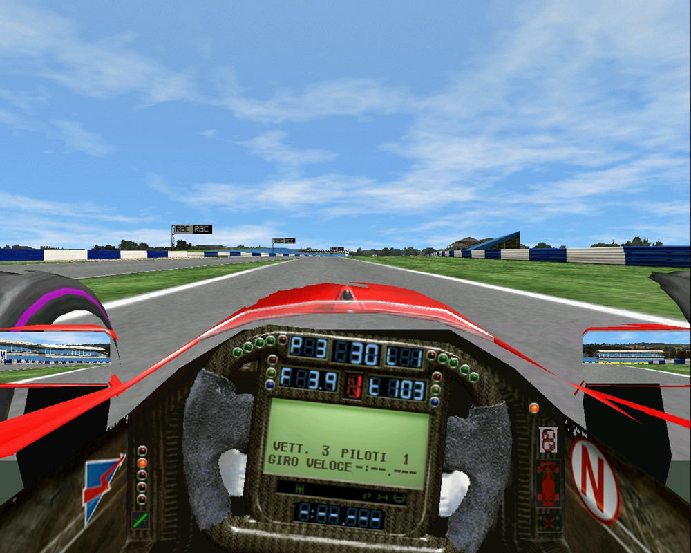

GP3 with dgVoodoo2:
Rendering is way better but LCD fonts are blurred/lores.
I'm using an old release of dgVoodoo, with the last one the rendering is a green mess, unusable.
