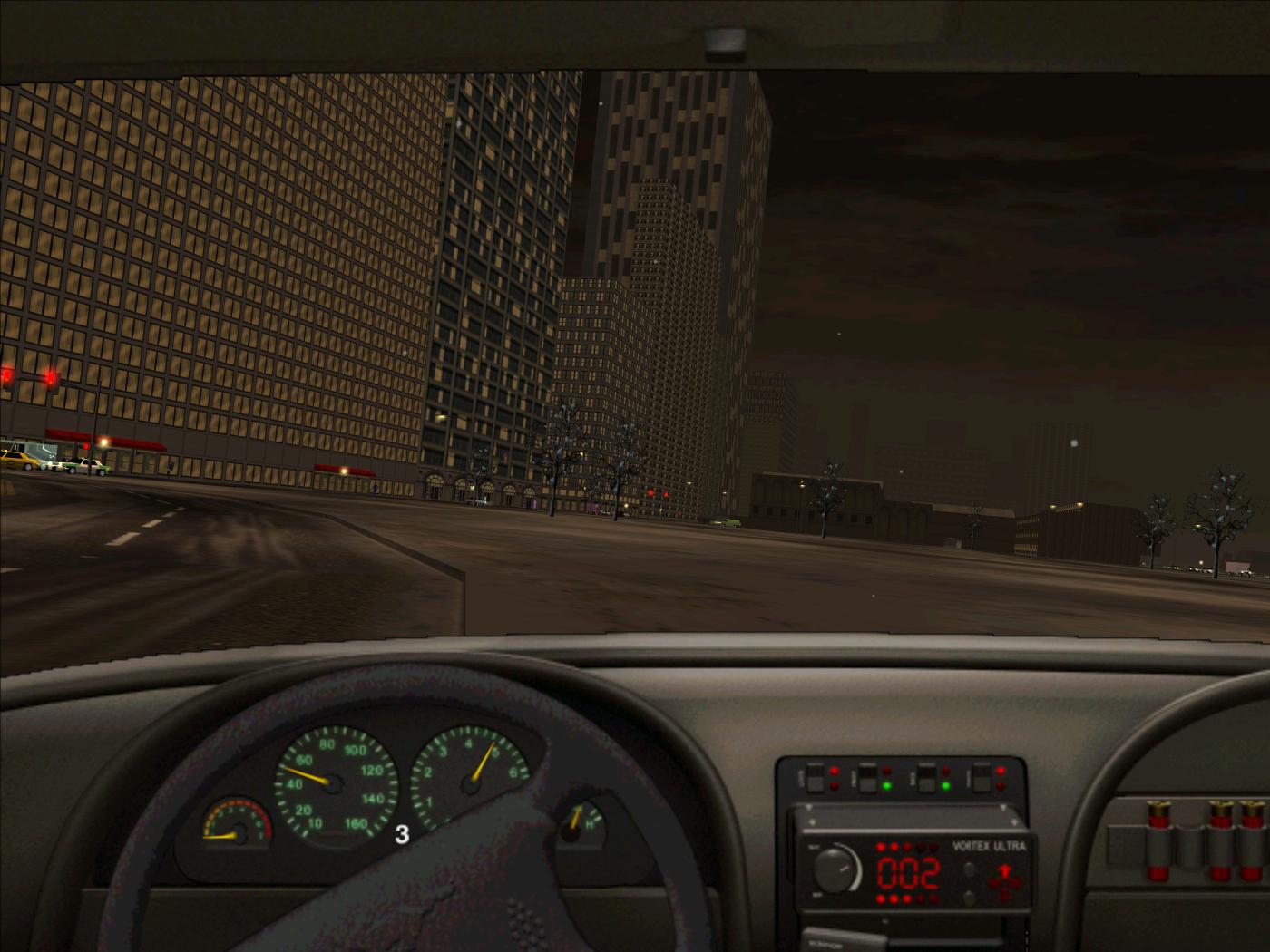

For some reason, running Midtown Madness 1 & 2, and Driver You Are The Wheelman through DGVoodoo, they refuse to run in 32 bit color - only 24 bit. I have Interstate '76 & Interstate '76 Nitro Pack running in 32 bit color fine through DGVoodoo. Should mention I'm on Windows 10 Pro 22H2 with a Nvidia GPU.

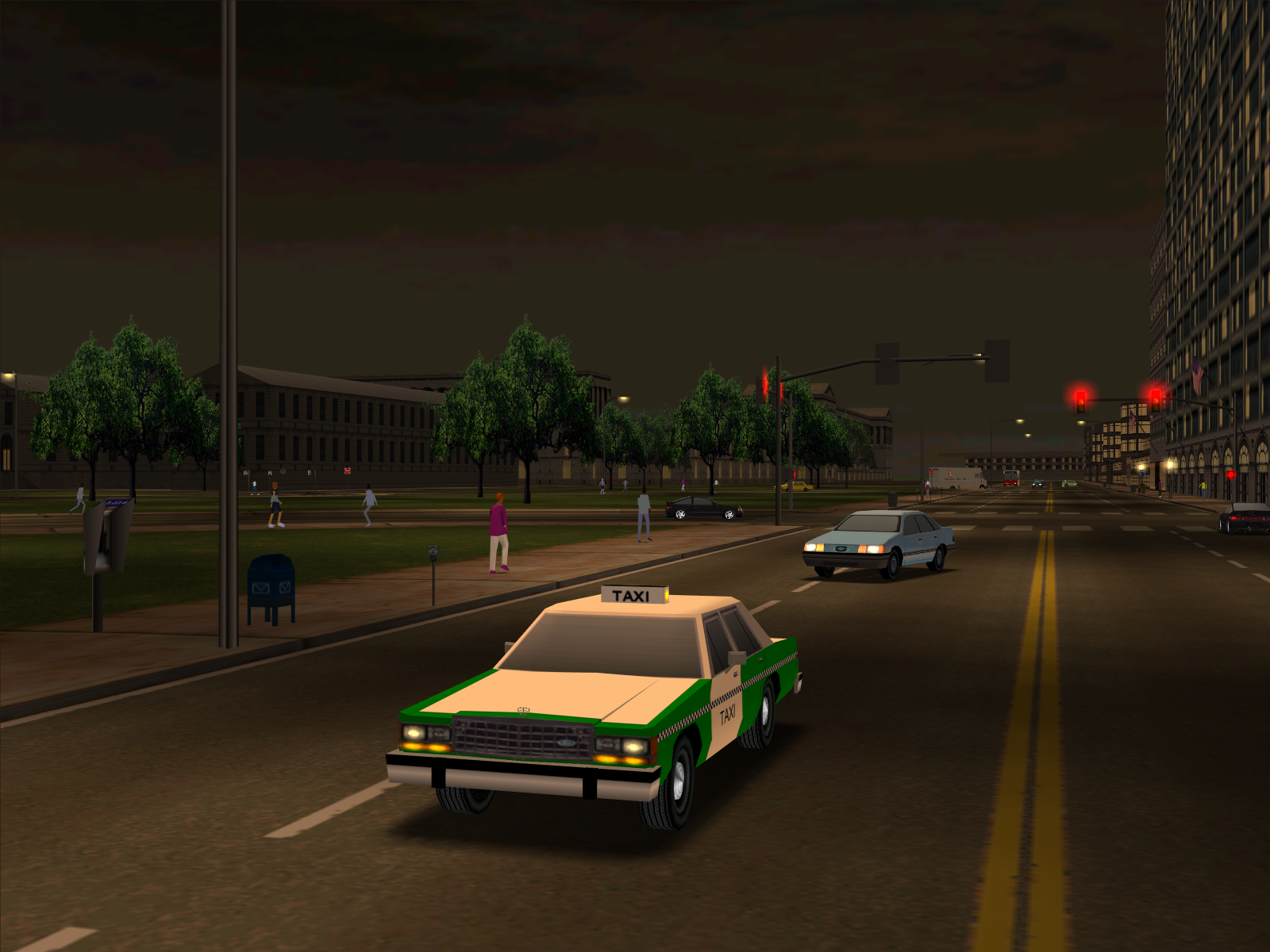

Reply 8 of 16, by 1CC960
Yup. it's working correctly. Apparently that skybox actually looks like that in that specific mod - Revisited 3. One of the mod preview pics showing night time has it looking like that.
There is tons & tons of banding in this image everywhere, actually.
I did notice the settings menu resetting my textures to "High" instead of "Very High" when I exit a session and go back into the graphics options menu though.

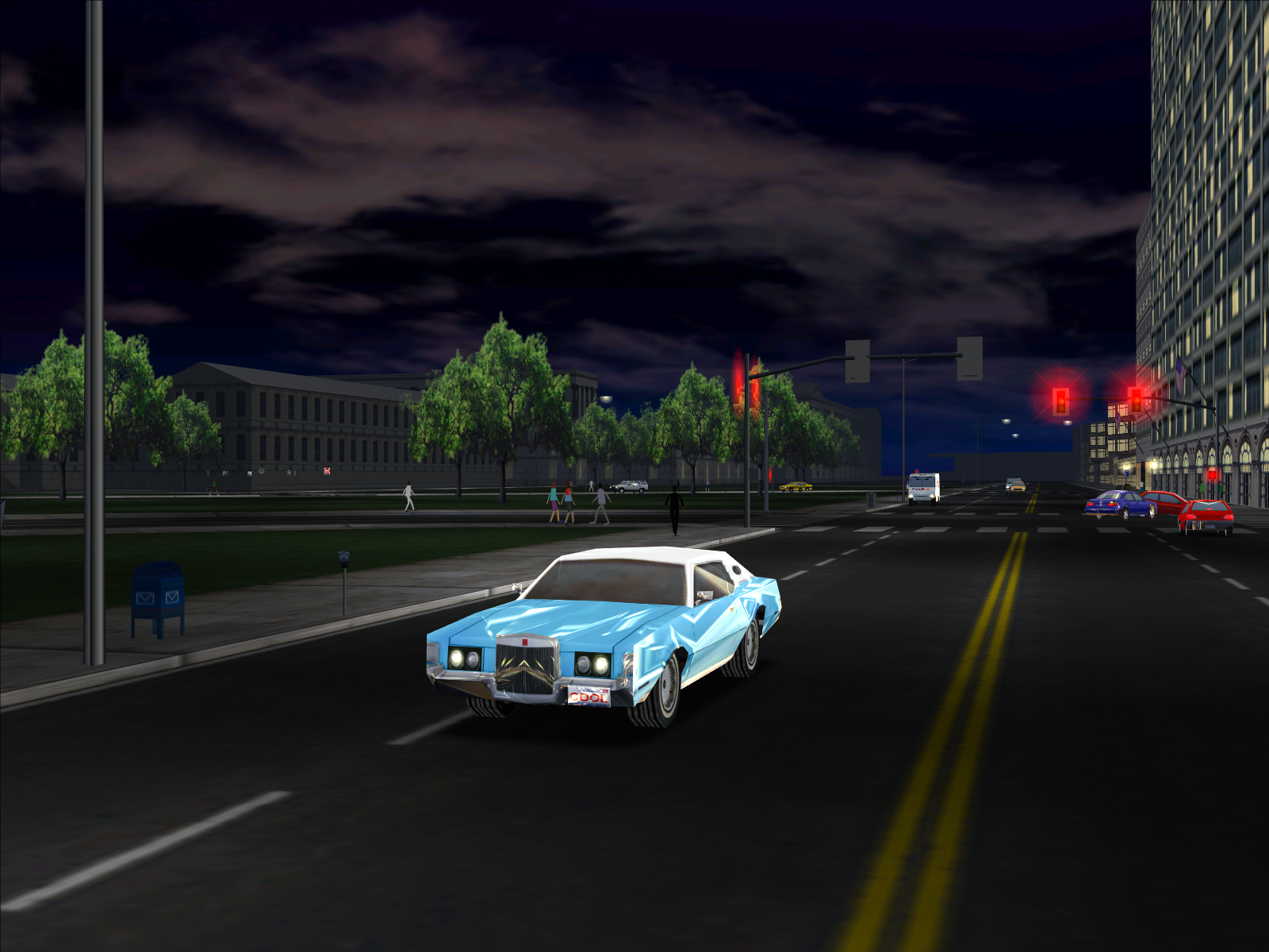

Reply 11 of 16, by BEEN_Nath_58
1CC960 wrote on 2024-01-20, 05:28:
It's related to the custom 3d skybox model that Revisited v3 implements here's the sky at night without Revisited 3: https://i.p […]
Looks perfectly normal.
This one doesn't have color banding... 32bit color I guess
