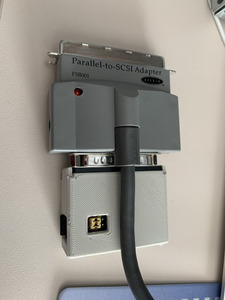

Reply 162 of 177, by Cloudschatze
Figured I'd do some tweaking of the GeoWorks desktop on the RL (oh, hooray) since I brought it out again for the Zip testing and all. I'm undecided as to whether I prefer the use of Windows 3.0 or GeoWorks 1.2 on this system, but surely either is preferable to Deskmate.

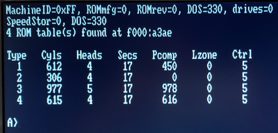

Reply 164 of 177, by dr.zeissler
I have a problem! One key "u" is not working on my Tandy-Keyboard. Every other key is fine. I have to investigate the problem.
I have no other Tandy 1000 keyboard, so this will likely be a big problem. I'll keep you informed how this turnes out.

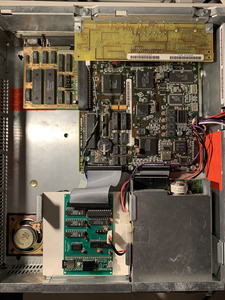

Reply 165 of 177, by dr.zeissler
Upgrades:
Tandy-Keyboard:
Fixed the keyboard! it's working great again but that was a hell of a ride...
XTA2SD:
- 1x20MB is working
- 1x32MB does not work, because no bios-option for that
- 1x40MB is working, loading Dos from Rom and switching to C: for config.sys and autoexec.bat, C:32MB and E:8MB (D: is the Romdrive)
- 2x20/40MB both not working!
LPT-issue:
- still no real progress
- after reading tvdoogs lpt writings I am sure that even if E2-E3 connected (soldered) palmzip still does not work.
- palmzip (zipdrive) is only working on a real lpt-card that is set to primary. No slot free because of the VGA-card and no VGA-LPT-Como available.
- still have not figured out how my LPT2SCSI works and driver locks up the machine.
@cloud:
can you give me your config.sys/autoexec.bat of your T1000RL/HD.
Thx!
Doc

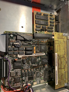

Reply 166 of 177, by dr.zeissler
I switched out the VGA card and put an real LPT in it. It's jumpered to SPP and 378/I7.
palmzip-driver is loaded, reading zip-disks is working writing not. I deactivated both bios-settings for "LPT=OFF" and "Lpt-OE=OFF"
I think I have to probe different settings.

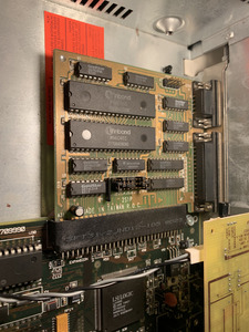

Reply 171 of 177, by dr.zeissler
Changed irq2->5 on harddrive and back again...no luck, changed every setting on lpt-card, no luck.
put another lpt-card in, works right out of the box. "lpt_test" fails on bi-directional but it works.
the lpt card offers one additional serial port too...I have other cards that offer a game port too, but the tandy1000 already has two game ports...I am thinking what card I should choose, perhaps I would go and checkout if the lpt/game card works too.

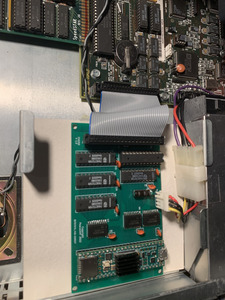

Reply 172 of 177, by dr.zeissler
I stayed with the parallel/serial-card because with this setup I can use interlnk/intersrv and serial2midi without switching the cable.

Reply 173 of 177, by dr.zeissler
After some time and a fresh install of the midi devices I have done wrong, don't know what I did, tested some thing and can not find out why my midi-devices play the music way too slow.
Strange, I messed it up. What should I look for?
I don't think it's the LPT card, neither the XTAHD...

Reply 175 of 177, by Cloudschatze
sangokushi wrote on 2023-05-20, 19:07:
Cloudschatze wrote on 2022-07-06, 18:16:
The connection is indeed basically identical to the diagram, but with the addition of an HD50F-to-DB25M adapter between the Shut […]
The connection is indeed basically identical to the diagram, but with the addition of an HD50F-to-DB25M adapter between the Shuttle interface and the Zip drive.
Here's an example of such a setup, with Windows 3.0 running off of the Zip drive.
Driver-wise, you'll need a minimum of EPST.SYS/EPST.EXE paired with ASPIHDRM.SYS/ASPIHDRM.EXE from any of the Shuttle software packages (where the .SYS versions are loaded at boot via CONFIG.SYS entries, or where the .EXE versions can be loaded anytime afterward instead). I can supply the exact versions I'm using, if those are needed.
Now, this all assumes you've installed the necessary jumper pins on the RL motherboard for this to work... 😀
Also, bear in mind that the SCSI Zip drives do not supply TERMPWR, so you'll either need to use an external adapter to power the Shuttle interface, or chain an additional SCSI device to the Zip drive that does supply TERMPWR.
Where can I buy the white external power adapter?
The Shuttle adapter requirements are 5V DC, 500mA, center-negative. In the photo, I'm just using a multi-voltage adapter from Radio Shack in conjunction with Adaptaplug "H."
