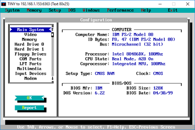

Reply 19 of 20, by GL1zdA
This TINY program is sweet. Has some quirks (problems sending Alt+Letter, requires Novell TCP/IP stack), but it works well most of the time.
    20.1 KiB
    466 views
    TINY running on a PS/2 95 with Check It PRO
