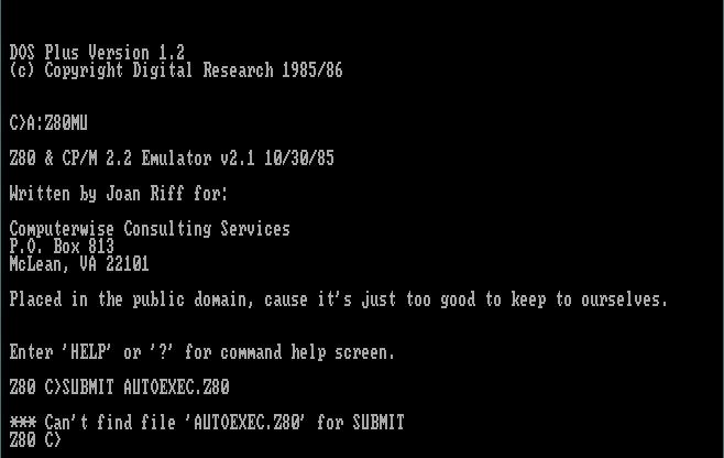

Loading from DOS 3 partition..

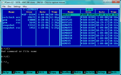

Anyway, I'm just asking because I get weird results in PCem and other
emulators when I do perform the installation via MS-DOS 3.2 only.
For some reason, DOS Plus can't find any files on the "C:" drive after a
reboot when the installation was finished. It also can't find COMMAND.COM (or dosplus.com),
even though DOS 3.2 sees them both.

DOS Plus can't find the command processor that MS-DOS 3.2 and FIXLDR copied to "C:".
What could cause this ?
I wondered if DOS Plus was using the second FAT or relies on any other unique behavior.

Here's what happens after you were running "CONFIG" with both DOS Plus and MS-DOS.
I was not using the Amstrad PC1512 setting to avoid XT-IDE BIOS.

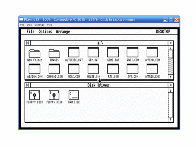

    22.98 KiB
    2199 views
    Running GEM from the PC1512 disks on a 286/CGA configuration.
    Mouse not working yet, but mouse cursor can be moved via keyboard.

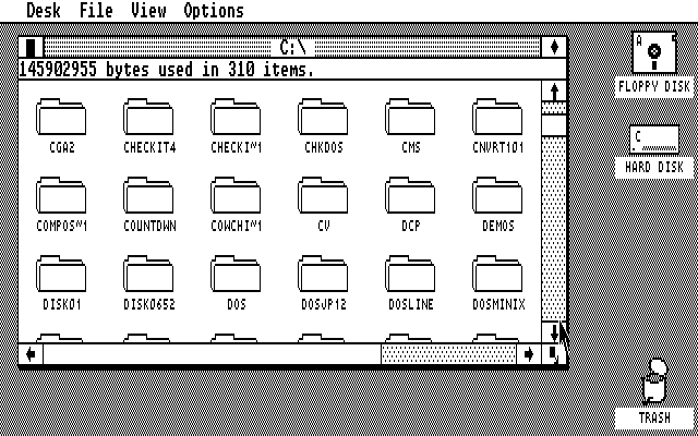

It's a later version of GEM (2.x). I love 1.2x because you can install it everywhere and it has no limitations in usability because the apple-lawsuite was later.
what I really like about Amstrad-Gem is that it comes with locomotive-basic. I did not have tested installing locomotive-basic on top of gem 1.2x.

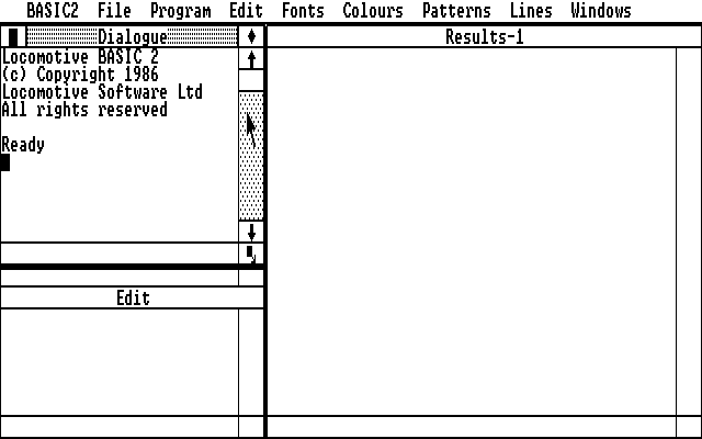

Reply 16 of 18, by Jo22
You're lucky, Locomotive BASIC 2 runs just fine on GEM 1.x. ^_^
Edit: I've recorded a video for you!
It's available here: https://youtu.be/EH0BGEVYNYk
Have fun! :)

Update - Good ol' Z80MU runs fine on DOS Plus! :)
This is interesting, since my copy of DOSBox is unable to run the '85 release properly.
    3.69 KiB
    1860 views
    Z80MU on DOS Plus
    CP/M 86 -> PC-MODE -> Z80MU (CP/M 80) -> CP/M-80 programs
    z80mu21_backup.zip
    96.25 KiB
    79 downloads
    Z80MU by Joan Riff (v2.1, 10/30/85)
    Released in the Public Domain
    Note: My copy originated from an old backup.
    It may or may not be one of the corrupted copies, so no warranty.
