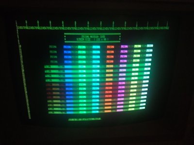

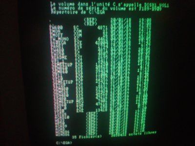

Reply 6 of 7, by Deksor
Just tested : the 860EGA.exe program works like a charm, just look at this !
1.06 MiB
840 views
666.39 KiB
840 views
HD EGA x) (sorry for the blurry pictures, it's night and the CRT has some issues at the moment)
Edit : according to my manual, the card can even emulate some VGA modes ! 😮
It's not documented in the program, but you can still use the modes' codes and that seems to work properly.
