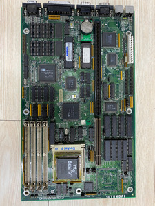

Reply 345 of 359, by ychh0
It was produced by Hyundai Electronics in Korea. It seems it was released in 1994 and the Model name is “Hyundai Solomon Merit Green”

Reply 346 of 359, by ychh0
jheronimus wrote on 2023-05-10, 12:33:
ychh0 wrote on 2023-05-10, 11:56:
Here is the bios, I could read bios with setting chip as AT27C010 and its 128kB
Please check if it is valid or not.
Do you know the name of the system this board came with? Is it Hyundai Solomon?
Here is mainboard picture. Please check it.

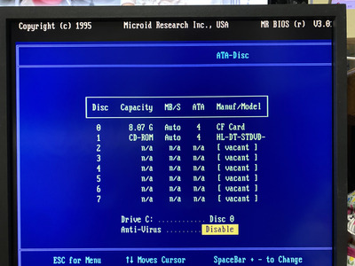

Succeeded!

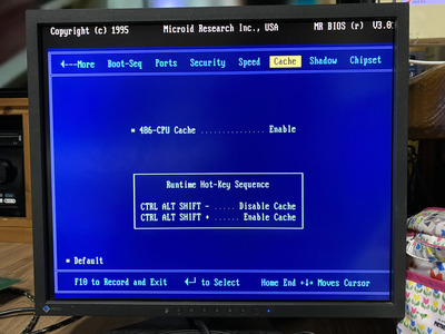

MR BIOS 3.21 did not boot but 2.01 and 3.01 boot up well. (I have no spare 27C010 chip, when I get UV eraser I will try again, it could be flashing was not proper)
Original BIOS is configured with VGA BIOS in first 64kB and AMIBIOS in the later 64kB. So I used hex editor to merge 1st 64kB with VGA BIOS and the later 64kB with MR BIOS.
Now it can recognize 8GB CF well and also can adjust wait state. (Originally NSSI benchmark was 17,717 dhrystones/s and now its 18,448 dhrystones with wait state 0)
But I wonder how I can enable L2 cache . There is jumper setting on the mainboard and installed 256kB (9 KM68257CP-15 32K*8 Bit, including tag ram) but it was not working originally and still no option to enable it.

Reply 348 of 359, by jheronimus
ychh0 wrote on 2023-05-12, 12:57:
Have you tried external tools to check L2 cache? Attached cachechk, pretty much the go-to tool for this.
I'd also try the image for OPTi 895 as the last resort. I think 895 and 802G are very close (the difference is mainly the memory configuration), and 802 should be just 802G without the "green" features.

Reply 349 of 359, by ychh0
jheronimus wrote on 2023-05-13, 13:22:
I found that if device is properly set, MR BIOS shows information or option menu to adjust that property. Currently cache ram menu is not shown that means there are problems. I checked some line tracing from cache ram socket but failed to find any breaks. And also tried several cache rams but in vain.
Now, I removed all cache rams from mainboard because there are memory problems. Especially when writing dozens minutes, it occurred memory problem and rebooted. Also when soft reset sometimes it did not boot well, I had to completely power off and restart from power on.
Without cache ram installed, those errors are completely gone.
