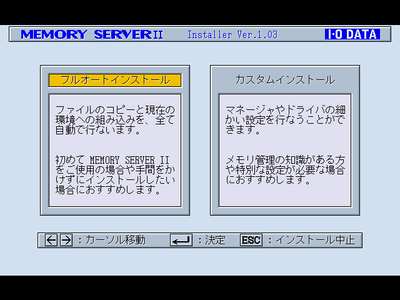

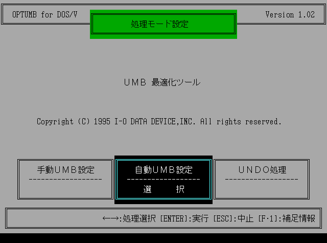

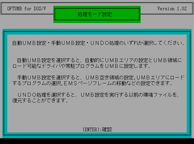

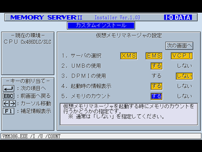

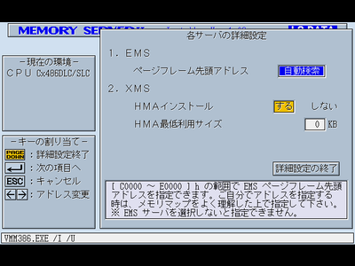

Some screenshots of the Memory Server II installer and of the UMB Optimizer:

Wow, thanks a lot for these pictures, lolo799! :D
IMHO, it looks quite polished and nice and tidy..
A bit like the GUIs of Towns OS or Human 68k from other platforms.
