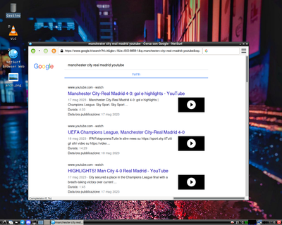

Here the best lightweight browser I found

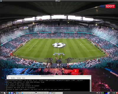

Watching football game highlights (YouTube webapp is too heavy for this machine 😁)

Don't have the screenshot, but it also runs Telegram Desktop pretty good.
Are you using mpv to watch calcio?
Probably a newer video card with H264 support and the proper drivers would be a game changer. The cheap G210 is up to the task!
I stream the video data with yt-dlp and send it as input to mplayer.
I believe the CPU is the bottleneck for the YouTube webapp: maybe it's because a lot of modern web pages are bloated with heavy assets and JavaScript (considering frameworks too) so it just can't keep up.
In fact Telegram is lighter and runs pretty well, while Discord, which has a lot more animations for example, runs like crap 😁

I have played h264 at 360p (-f 18 using yt-dlp) on a Pentium III and it works fine so you probably could play 480p with a Pentium 4.

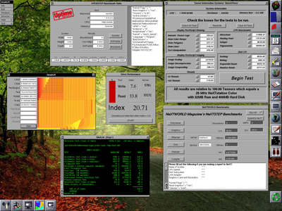

Here is OpenStep 4.2 running on a PIII 1.4ghz
This is using a Aha-2940UW scsi card
(pro tip don't use partition sizes over 4gb & I havent had good luck using drives over 40gb)
1.25 MiB
674 views
Installation media here https://fsck.technology/software/NeXT/OpenSte … OpenStep%204.2/
Partial Hardware compatibility list http://www.rhapsodyos.org/hardware/os-ns_guid … s_guides_1.html
