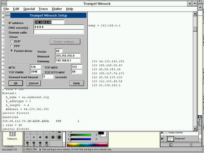

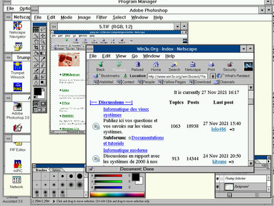

EMM386 might the first problem, my Intel NDIS DOS drivers do not work along EMM386.
Microsoft TCP/IP 32b package might be another problem. TCP/IP from Microsoft worked perfectly on a i7/3770 HP workstation - but not a Pentium 4 machine - using the same network card/drivers. On another config, Windows couldn't load after installing MS TCP/IP even if there was no network activity. (no drivers installed)
Plan B is to use Trumpet Winsock TCP/IP. Trumpet... is not as plug and play as Microsoft TCP/IP. You have to deal with packet drivers, vectors, no DHCP, but once you're done... it performs pretty consistent.
