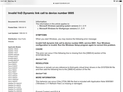

Hi, I am trying to restore my IBM PS/1
It had a harddrive image install of DOS 6.21 and Win-3.1
I wanted to add Network TCP/IP support and a 3com NIC card so I
Tried to upgrade to Win-3.11
I installed Win-3.11 and selected to upgrade the OS.
The install appeared to go well with NO errors.
But when I rebooted I received errors.
I had a few errors complaining about xxx.386 files being missing that where being called by the System.INI file.
I searched the hard-drive and backup original image but could not find the mentioned xxx.386 files.
So I commented out the entries in system.INI.
I also performed a reinstall just to make sure all was well.
The reinstall want well with NO errors.
When I reboot Win-3.11 tries to start but then exits to DOS.
I also receive this error “ Invalid VxD”
Any Ideas on how to fix this ?

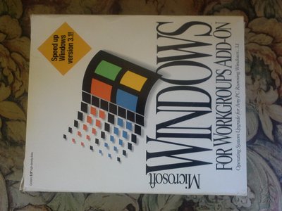

For a start it's Windows for Workgroups 3.11 The normal WfW 3.11 wasn't designed to upgrade Windows 3.1/3.11. There was an upgrade package , which was a full Wfw 3.11 release with the first disk altered, for that. It was called Windows for Workgroups Add-On. Either remove your current win3.1 setup and replace it or install Wfw 3.11 to another directory on the same hdd.

Yes, I was able to get it going. I just had to edit the System.INI file.
added DEVICE=*vtd
I added TCP32b package for Win3.11 to get Networking going.
Works fine now. Thanks all.
It's a normal full version of Win-3.11-WFW. During the install I was asked if I wanted to replace or upgrade the OS and I chose upgrade option.

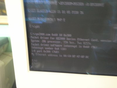

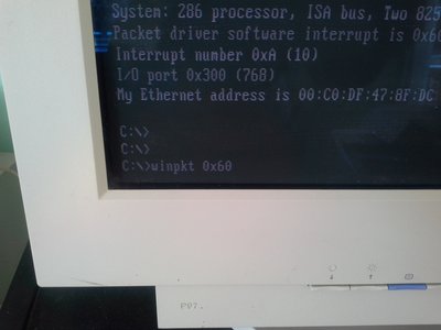

The Win3.1 to Win3.11 is just half a dozen core file replacements. There is no network support involved. You can get the files from http://www.conradshome.com/win31/ File name is WW0981UD.EXE
Reply 11 of 11, by Caluser2000
Intel486dx33 wrote:
Oh, Nice. So which packages and updates do I need to add TCP/IP and Network support in the 3.1 install.
I want it to work like WinNT 3.51

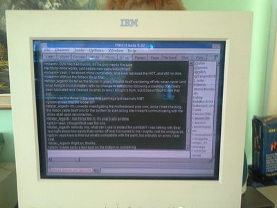

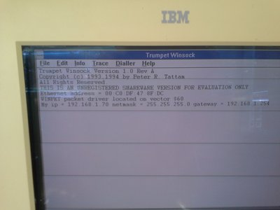

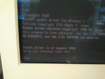

WfW 3.11 gives you that functionality. For plain Win3.1/3.11 as I mentioned earlier you get TCP/IP functionality by using a Dos nic packet driver, winpkt.exe(wich is a shim between Dos and Win 3.X for the packet driver) and TCP/IP winsock such as Trumpet Winsock. You can use WfW telnet and ftp clients in Win3.1/3.11with the winsock installed. Also you run an irc client, use a web browser if you are masocisistic enough, etc. with the winsock installed.
They say a picture is worth a thousand words so here goes:-
975.45 KiB
766 views
1.1 MiB
766 views
1017.71 KiB
766 views
1.24 MiB
766 views
1.37 MiB
764 views
My Zenith Z286LP Plus, a 286/12, running Windows 3.1 with packet driver, winpkt and Tumpet Winsock loaded running PICH16 irc client.
