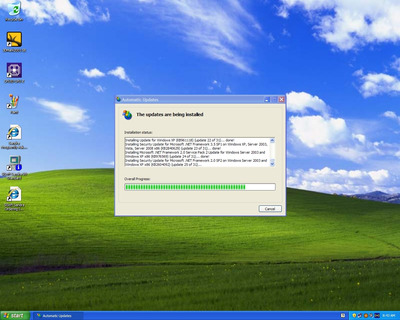

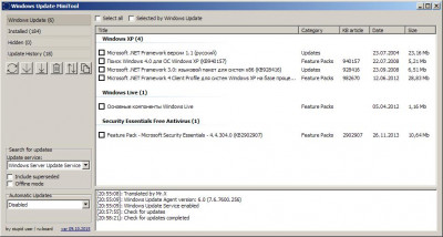

Reply 9 of 16, by Gamecollector
The instruction misses 1 step.
8.5. Select "WSUS" in the WUMT "Update Service" droplist.
Tested on my retroPC (WinXPSP3 Pro), updates were founded, downloaded and installed.

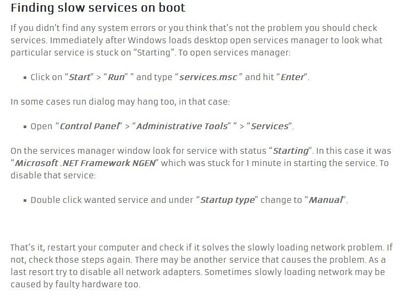

On a couple of vintage systems where I've done the updates there will be a very annoying lag on startup - you get to the desktop, but the network icon for the system tray takes forever to appear, and the system is basically locked up until it does appear. This is the cause:
