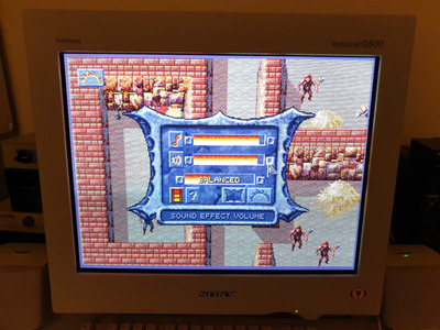

Hi!
Did anybody get this to work on real hardware?
I tried everything I could think of to get it working on my 440BX Pentium III, with a CT2230 Soundblaster16 + X2GS or WP32 McCake in any MIDI-mode but no luck.
When starting the game, the sound card get's initialized with an audible noise but then the screen just stays black.
Soundblaster only and MIDI only both work fine.
For reference here's the other thread on sound for this game I could find on vogons: Dark Sun music
Additional note: Tried German CD and floppy versions as well as the gog.com version. Alltough the 1.1 patch notes seem to mention fixing some dual soundcard issues this did nothing for me
Reply 1 of 20, by AppleSauce
Yeah I got the English version 1.1 working with CM32L + Sound Blaster 16 CT1740 on a 430TX Pentium 1

Reply 2 of 20, by Shponglefan
Just tested it using SB Pro 2 mode on a GUS Extreme (ESS1688F chip) and Roland SCC-1. Both MIDI options (SCC-1 or MT-32) work just fine with the SB audio.
I realize that's not an SB16, but at least an SB Pro compatible chip seems to work with dual sound card setup.

Reply 9 of 20, by GrafWasili
OK the files are identical that's not what was happening.
In fact it's as follows: The game only start's if I change the cards IRQ with diagnose.exe and use the new IRQ for playing (tested 5 to 7 and 7 to 5).
It must be different from the IRQ set via autoexec.bat or it won't work.
SET SOUND=C:\SB16
SET BLASTER=A220 I5 D1 P330 H5
c:\SB16\DIAGNOSE /S
Still puzzled and trying to find out what's happening here...
EDIT:
It does work with the following autoexec.bat
SET SOUND=C:\SB16
C:\SB16\DIAGNOSE /S
SET BLASTER=A220 I7 D1 P330 H5
c:\SB16\DIAGNOSE /S
C:\SB16\MIXERSET /P /Q

Reply 12 of 20, by Shagittarius
Well I was wondering if you were loading the right drivers depending on the PNP status of your particular SB card. I have a CT 2260 which is semi-pnp, and as such that site is useful for pointing out the programs to run in your autoexec to support it. But this doesn't sound like your issue.
One thing I am thinking of, I notice you have the midi of your SB set to 330, how are you running the MT-32 , is it through the Soundblaster or MPU-401? Make sure there is no clash there. A freeze is usually an IRQ based problem though not always...but the fact that they both work separately makes me think a conflict of some sort is to blame...

Reply 13 of 20, by eddman
Are SET SOUND and DIAGNOSE even necessary for a non-PnP SB16 (isn't CT2230 semi-PnP)? I've never used them.
I don't know if it matters, but the SET BLASTER command is missing T6.
It's possible the game forgets which IRQ to use. Run the SETUP again and choose the IRQ value you've set in AUTOEXEC.
EDIT: Since the IRQ of semi-PnP blasters is controlled by windows, maybe it's constantly changing it? Although you're apparently running the game in DOS.
Reply 14 of 20, by GrafWasili
Yes the CT2230 should be what's called semi-PnP and setting the IRQ via Diagnose.exe ist what always worked before and seems to be recommended in most vogons threads on the topic... And yes I'm running in DOS only the WIN95 thing was a red herring. I removed the T6 part of the blaster variable as a possible source of problems - didn't make any difference in this case.
I know for a fact the game doesn't forget the IRQ-Settings - they are encoded in the sound.cfg file and the game throws a very specific error if the IRQ doesn't match.
It's only that I have to switch it once (or initialize it twice to different IRQs, to phrase it another way) before it starts working. It's like following some kind of retro cargo cult tech support: »Have you tried switching IRQs?«
