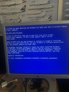

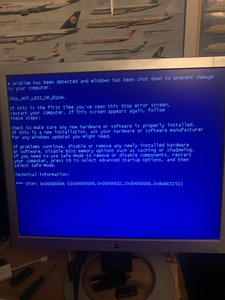

The 2000 disk is SP4, the XP is SP3. There is no ACPI by name, but disabling power management made 2000 get past "Starting Windows 2000" once though it immediately bluescreened. Selecting the Standard PC HAL in both 2k and XP changed the second parameter of the recurring BSOD to 0x0000001C.

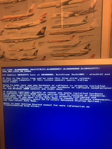

I've tried disabling what you suggested Meatball, now it's back to the original error. I can't revert to another BIOS because the one one there is the only one that supports >32GB disks and fits on a 1Mbit EPROM.

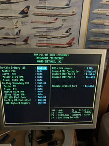

Reply 11 of 25, by Meatball
Try installing the OS on another system (with the SSD transferred). After the copy phase is over, bring the disk back to the SS7. This is a reach, but I'm running out of ideas!
Maybe you could post here all of the BIOS settings as configured for us to review?

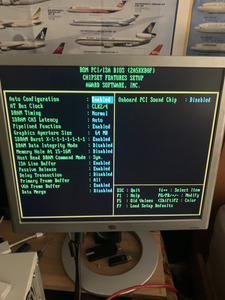

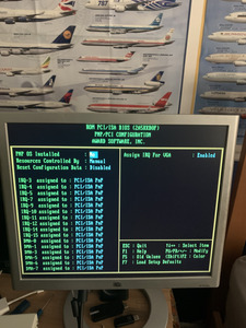

Reply 14 of 25, by Meatball
Some things to test:
"Enable" Power Management. There should be a "User" setting.
Set Power Management by APM to "No." For Windows 9x, I set it to Yes to disable ACPI, but not for Windows 2000/XP.
Optionally, disable Power Management PM events for COM Ports and Keyboard to "No."
PnP System should be set to "Yes" except for Windows NT 4.0, 3.x, and earlier; Windows 95 can be less fiddly from being off, though, depending on hardware installed.
Resource Control should be set to "Auto" unless you have a specific IRQ/DMA you need to set for an ISA card. You're not using DOS/Windows 9x, so no need for manual. (unless you're going to dual boot?)
Enable PCI Delayed transaction. This hurts PCI performance as disabled. Only disable with non-2.1 compliant hardware.
Set VGA Frame Buffer to "Disabled," your newer cards will not benefit.
You probably don't need to assign an IRQ to VGA because of Windows 2000/XP - only useful for Windows 9x (on occasion) depending on the Video Card requirements. Optional, but since nothing is working...

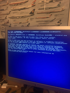

Reply 17 of 25, by Sukhoikip

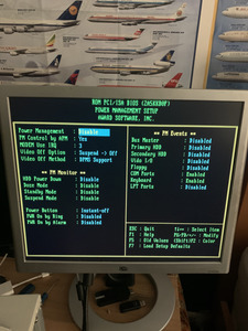

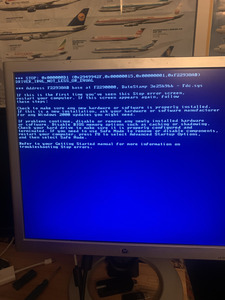

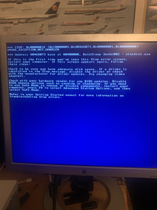

Meatball, I tried the above settings, it generates a different error, attached. After a few POSTs the system stopped POSTing and instead made a couple long beeps followed by endless short beeps. Clearing the CMOS seems like a good point to stop for the night.

Reply 18 of 25, by Meatball
Sukhoikip wrote on 2023-05-28, 02:38:
Repo Man, I set the timings to "slow" which is the best the BIOS would allow even if the RAM was the problem. The RAM is probably fine as it's the same kit I used for hwbot X265 on my S370, during which it ran for almost 30 hours at PC140. Is there a way to just get the memtest program so I can run it from the DOS prompt rather than burn an entire CD to test one system?
Based on your description of the most recent POST codes, I wonder if there is a CPU problem. Have you tried a different K6-2? Are you able to swap in a Pentium MMX?
You didn't use the F5 and Standard HAL setting in this scenario, right? You shouldn't, but just checking.
Reply 19 of 25, by Sukhoikip
Meatball wrote on 2023-05-28, 03:06:
I did try the Standard PC HAL with the BIOS settings you suggested, didn't realize I shouldn't. I do not have another socket 7 CPU, but I'm not inclined to blame it unless the system doesn't recover.
