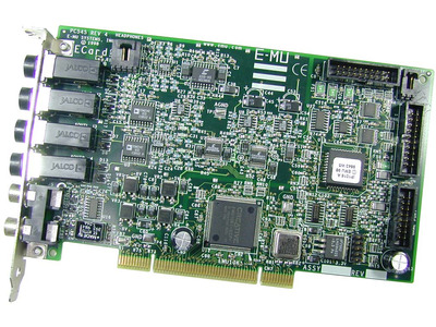

Requires Windows 95+
complete audio system including: 64 voice soundfont sampling -multitrack hard disk recording -multichannel effects processing -multi input digital mixing
E-MU actually developed its 10k1 chip for processing and recording music and sound effects.
In 1998-9, such a number of effects on 64 channels Athlon 700MHz / P3 Copermine 733 simply would not have taken out.
Then Creative bought E-MU and destroyed them. However, like Aureal.
