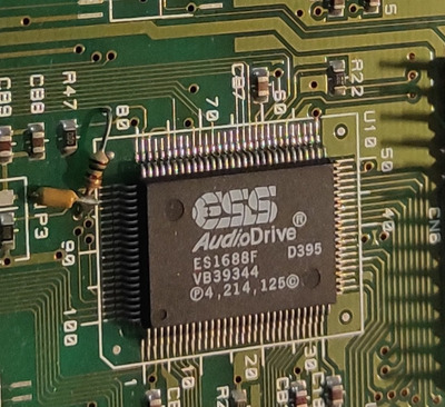

I have a few questions about ESS1688F.
I'm trying to install DOS drivers from Vogels site:
ESS 1688/1868/1869 Pre-installed for DOS
http://vogonsdrivers.com/getfile.php?fileid=616&menustate=0
but with no luck.
I haven't dealt with DOS for a long time and I don't remember everything 😉
Are these drivers for my sound card? My sound card has a hardware volume.
How to set up this card in DOS correctly? I have Roland SC-88, DB15 2 Midi, midi and rca-jack cables
Thanks!

Reply 228 of 318, by SScorpio
Koveras wrote on 2020-11-10, 16:01:
I have a few questions about ESS1688F. I'm trying to install DOS drivers from Vogels site: ESS 1688/1868/1869 Pre-installed for […]
but with no luck.
Is that a PnP card? I see a bunch of jumpers, but are those only to enable the different CD interfaces?
UNISOUND lists support for some of the ESS1688 cards. UNISOUND - Universal ISA PnP Sound Card Driver for DOS v0.82a
Reply 230 of 318, by SScorpio
Koveras wrote on 2020-11-10, 16:41:
Unisound tool shows "No PnP sound card detected"...
Looking at the Vogon driver you listed, it says the card is already in SB Pro on boot, so it sounds like things are hardwired and you can't change them. You do need to run the utility to enable the MPU401 interface.
Just run the following and games should be able to see the SB Pro card at Port 220, IRQ 7, DMA 1
SET BLASTER=A220 I7 D1 T4
The go.bat file in the 1688 subdirectory just does the below which supposedly enabled the MPU401, and sets the BLASTER statement.
ESSCFG /M:e /B:330
SET BLASTER=A220 I7 D1 T4 P330
Just plug in headphones into the jack between the volume wheel and gameport as a quick test. I don't know if that Line port is a line in or out. If it's out, you can hook up powered speakers to it.
You need a gameport to MIDI cable to connect your SC-88. Then in a compatible game set General MIDI or Sound Canvas and use port 330.
Reply 231 of 318, by badmojo
That's my favourite Audiodrive you have there @Koveras. The driver you linked to should be fine, here's what I have in my Autoexec.bat:
C:\DRIVERS\ESS1688\ESSCFG.EXE /A:220 /I:5 /D:1 /M:S /B:330
C:\DRIVERS\ESS1688\ESSVOL.EXE /A:10 /C:100
That should do the SET BLASTER variable for you, and no it's not a plug and play card.

Reply 234 of 318, by Koveras
Thanks guys!
My autoexec.bat looks like now:
C:\ES1688\ESSCFG.EXE /A:220 /I:7 /D:1 /B:330 /J:E
C:\ES1688\ESSVOL.EXE /V:12 /L:8 /W:12 /M:0 /C:12 /S:12 /A:0
In Doom music sets to Sound Canvas on Midi port 330 - now music sounds beautifull!
But there is no FX sounds - only on PC Speaker works 😉
Reply 235 of 318, by Paar
It's entirely possible you have a wrong version of ESSCFG. Does your card have ES968 chip?
Reply 236 of 318, by Koveras
Do you mean this chip?
Reply 237 of 318, by badmojo
Why /I:7? 5 is more commonly used. And what sort of system are you running this bad boy in? If it's "modern" (PIII for example) then you might need to jump into the BIOS and set aside the relevant IRQ for your card so that nothing else grabs it.
Reply 238 of 318, by Koveras
I don't know why 7 instead 5 😀
It is a P75.
Reply 239 of 318, by bloodem
