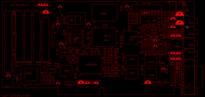

I've been curious, does anyone know of an ALS-100 based card with Yamaha OPL4 onboard? The design documents for the ALS-100 refer to a reference model with OPL4 support, but I can't find any examples of commercial ALS-100 cards with that.
I did however find old Gerber files for some of those reference cards, including this ALS-100M based design with SCSI CD-ROM and OPL3 as well as 4 support. Really interesting to see, but the old Gerber files are a bit difficult to work with.

Now THAT would have been a high quality ALS100 board! Hopefully it also isn't half as noisy as the majority of them. Sadly, these seem to be unobtanium, but not too hard to reproduce, if someone were to go through the trouble. After all, we have AWE64 Legacy, Snark Barker, BlasterBoard, ARGUS, Orpheus, Resound etc. so it would have been definitely possible! Dunno if that would have been worthwhile, though... Then again these things are niche anyway, but I digress.

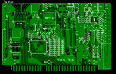

Yeah, it's a shame barely any ALS100 cards were made to the reference standard, but I suppose selling cheap ICs invites cheaper manufacturers. There's also Gerber files for a version with the Dream SAM9233 Wavetable synthesizer integrated onboard.

I am immediately considering actually getting one of these printed and trying to build it (not sure which of OPL4/SAM chips is easier to obtain).. Alas, I only have a 100+ card I can pilfer and I don't know if that chip works with external OPL chips or not, even though it looks pin compatible..

The SAM one can be printed with the Gerber files as is, at least at OSHPark and PCBWay (JLCPCB won't take them, might inquire about it as they tend to be cheaper), the Gerber files for the OPL3/4 version will need some work to convert them from what I believe is RS-274D to 274X, which I'm not super knowledgable about. As for the 100+, from what I can see, they're not pin-compatible with the 100.
The OPL3/4 one technically needs an ALS-100M, the "Multi-CD" version that does SCSI and a few other CD standards, whereas the ALS-100 only does IDE, but I think they are pin compatible. The MCD just accomodates the extra CD-ROM bits, which I'm pretty sure won't be a problem to leave out of that card when using an ALS-100. Don't think most people still need the CD-ROM drive controller capabilities of a soundcard nowadays.
The ALS-100 version of the card that does OPL3/4 only has the .SCH and .LIB files, which I'm not sure what CAD software they're for. An old one for sure, given they date to 1995.
I'm currently trying to see if any of the Alibaba sellers for "ALS100" ICs (which is not clear if it's even the right chip, mind you) can sell me a small quantity of those. So far, I've gotten two quotations for $15 and $20 per IC respectively, at a quantity of 10. Bit pricey, but probably still cheaper than finding ALS100 cards to pillage, as most on eBay are the Plus versions.

Those Gerber files can be converted to a newer useful format just like I converted the old Gerber files for the SIMMCONN. It just takes 2-3 different programs to get them to where they are easily usable.
Would you be able to attach those Gerber files in a zip or provide a link to them?
