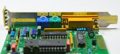

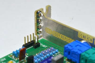

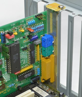

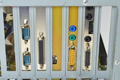

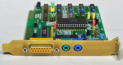

Feels like silence here... I'll wake you up a little!
I've made one of my concepts in the hardware: PC mounting bracket from PCB!
https://youtu.be/NRmj-7oqLfY?t=15m33s (Russian language, but you don't have to listen to understand what it is all about).

As simple as that.
Two milled PCBs, that are assembled together by soldering. As cheap as it gets: 1-sided, no soldermask, no silkscreen (but all those can be added if needed).
This bracket provides electrical connection to the PC casing and shielding (as does metal one).

Fagear, will those be available for ordering?
Those brackets will be supplied by default with new boards with no additional cost.

If there are spares going, I'd love to order those brackets as well - ideally 2 of them for my pair of replicas. Nice choice of colour, Fagear; they look like special editions.
