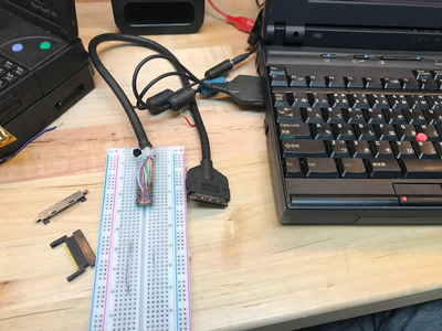

re: the IBM 3D Sound. Has anyone ever seen even a picture of the midi connector dongle for it? the "3D PCMCIA Sound Card Attach Module"
Seeing as my reproduction card uses the same HRS connector, I thought it would be helpful to try and make the midi/gameport dongle compatible to it. I have not yet sat down and figured out which pins are sound/gameport, I don't think that has been done by anyone so far?
15-pin, female D-shell type connector for attaching a joystick or a MIDI breakout cable
Built-in microphone
Two 1/8-inch, 3-connector phone jacks for attaching, connecting, or receiving (stereo or CD function)

Reply 456 of 558, by yyzkevin
I made a small breakout for the 25pin connector on the IBM 3D Sound, and after some initial poking around I was unable to identify the gameport or midi port.
- does sending the midi messages to the soundblaster midi port actually goto the external connector when in dos? I could not identify any serial data on any of the pins while playing with dosmid /sbmidi=220 I also did not hear any audio output (wavetable not loaded to dsp when in dos?).
-gameport, I also do not know does this work in dos? I am using the 220h setting which sets the pcmcia window to 200-22f to cover those ports. I saw one configuration option about gameport speed in mwave.ini but I did not see it mentioned in the manual.
maybe there are a set of pins that get bridged when the attachment module is installed and that brings the external functions to life? Given the cost of this card I am just not ready to cut it open to look at the inside for any hints on the purpose of each pin.
I suppose I should also try in windows for the purpose of identifying these pins. I am not going to sink too much time into it though as this is just to try and make my dongle/breakout usable on the ibm card also.

Reply 457 of 558, by Bondi
yyzkevin wrote on 2021-12-29, 05:40:
I made a small breakout for the 25pin connector on the IBM 3D Sound, and after some initial poking around I was unable to i […]

My understanding is that MIDI does not work in DOS, but the game port should work. It refers to mwave.ini in the manual here. I assume they mean DOS environment here, but who knows...
https://archive.org/details/ibm-3-d-sound-car … age/72/mode/2up
Do you also load the resource map utility DICRMU01.SYS? Aren't there any ports excluded with /PX switch?
EDIT. I doubt It would output MIDI to 220 port (/sbmidi=220 in dosmid). Theoretically I'd rather expect it on 330 port. Regular MWAVE card actually outputs MIDI to 330, I checked it on my 755CD laptop. Interestingly, it does not mention port 330 anywhere in .ini or readme files, but it works (in pure DOS). So just for fun you may also want to try /mpu=330 in dosmid.
