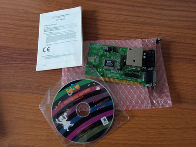

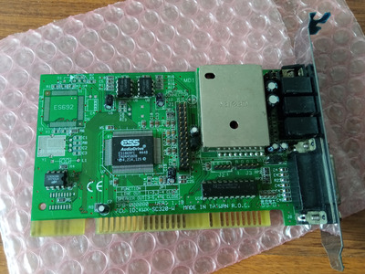

Reply 38 of 38, by Tirmikus
This is an old topic but the Win9x driver problem still persist with v1317. If I remove all drivers (no wdm, no antoher vxd driver) I can not use the sound card on Windows sounds as expected, but when I start an adlib game in Windows 98 dos box like Volfied or Supaplex it works without any problem and Sound Blaster Pro diagnostic tool find the sound card with default PnP BIOS settings (220 IRQ7 DMA1,3). After installing the 1317 driver SBPro diagnostic tool and some DOS games are unable to find the sound card especially games with adlib option (like Volfied, Supaplex). Card is working great in pure DOS mode.
Here is the interesting thing, when I change es1869.drv and es1869.vxd with any new version (ex. v1207) of es1868.drv and es1868.vxd and rename them as es1869.drv and .vxd, the above games works perfectly from Windows 98 Dos box. But there is a catch. With Es1868 drivers I lost Spatial Audio in Windows (because 1869 has integrated spatial audio and in 1868 it's a different external module) and in some Windows games it gives me a stuttering sound (3D Pinball etc.).
I think Es1869 drivers (I tested 8 or 9 drivers and all Win9x versions) has a bug like this. I tested 2 different Es1869 ISA card (one has an integrated FM Radio Module) and they are exactly same results.
It's not a life and death issue to not able to run DOS games from Windows but is there any modified version of Es1869 drivers around or any other trick to enable sound from Windows?
