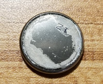

Reply 190 of 418, by Salient
Replaced mine finally as well in both my SC-55's.
They were indeed in poor condition by now, but haven't damaged anything (unlike the Varta stuff in a lot of Amiga's):
