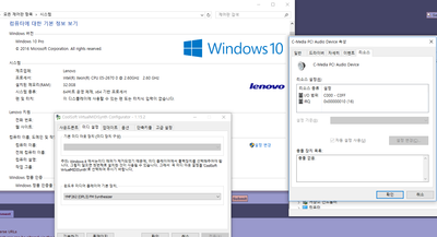

LENOVO Thinkstation S30, I've succeed to install kernel mode driver & FM passthrough to DOSBOX.
The only problem is I installed 1740 driver not googledriver link and googledriver link cannot installed in windows 10.
(It should be installed in windows 7 first and upgrade to 10, so there's no fm which software need fm address 220 not direct 388
next time I should install it first.)
Maybe C602 M/B is the fastest PC decision getting native PCI.

Reply 79 of 88, by ik777
datajake1999 wrote:
I just installed a cmi8738 pci card in my custom built pc. The motherboard of the system is an Asus TUF Z270. How can I check wh […]
How can I check what model of cmi8738 I have?
Edit:
I checked the adress of my cmi8738 is E000, so when I used peakpoke I set my address to E01a, and the data to 08, and peaking it returned 08. Does this mean I have hardware opl3 or not?
peek 388 if it won't be 00, does not.
