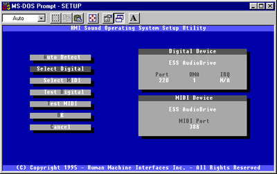

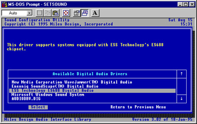

And just to illustrate what I mean by "Miles" and "HMI" sound systems, here are two screenshots:
Miles:
80.48 KiB
1940 views
HMI:
47.6 KiB
1940 views
Those screens may look different in some games, but Miles can usually be recognized by the presence of .DIG files somewhere in the game directory, while HMI can be identified by the presence of either HMIDRV.386 or HMIDET.DRV depending on the version.
