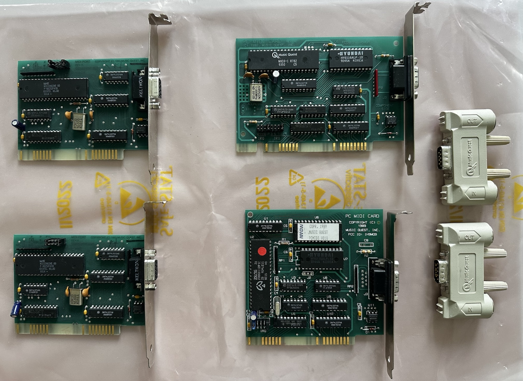

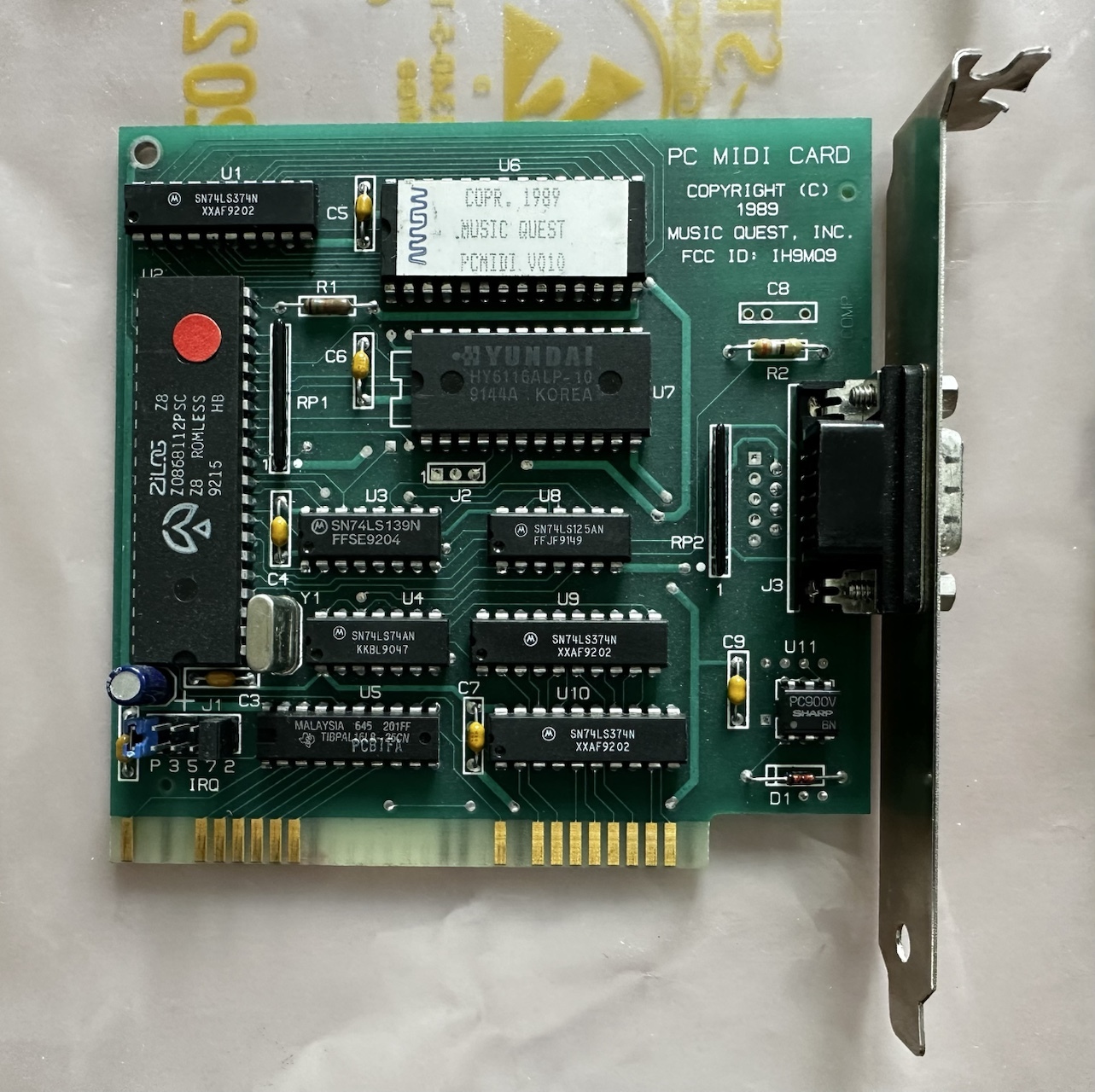

First of all, here is a picture of the card (notice the firmware version, it's v.004) , silkscreened on the pcb is the model of the card: IH9MQ9
Also the DB9 breakout is a cable based one, not a solid block with the ports.

So how do you setup the card? It's easy, there is only 1 jumper block on the card, here are the configuration options it offers:
Basically, to be Roland compatible you need to jumper "P" and "2" so the card uses port #330 and IRQ 2.

I wonder if v010 of the firmware fixes these errors , mine is v004... I am getting a dead 010 card so hopefully the eprom is fine and I can use it for testing , will report my findings when I receive the dead card

Removed the eprom, it was an OTP 64kbyte chip whith the 010 firmware version. Already dumped and stored, will try it on the good card once I put a socket on it's eprom. Also removed the crystal to see if a replacement gets it going. Else I'll just replace all the chips 🤣

First post edited, rom version 010 corrects the Wing Commander crashes, so basically the card just works fine. If you know another problematic game please tell me to test it.
