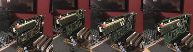

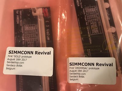

With a great thanks to Dreamblaster, I had an opportunity to test Gold and Universal SimmConn Revival on my AWE 64.
81.85 KiB
1379 views
SimmConn Revival Gold and Universal Prototypes
In the beginning I tested memory modules 4-16MB on both Revival and "Original" SommConn's. Due to some differences with detecting theese memory modules on all three of SimmConns, I decided to focus olny on 32MB sticks. (I don't think that anyone using SimmConn on AWE64 would like to use 8mb if 32mb modules are very common)
188.65 KiB
1379 views
6 different memory (32MB)
I used 6 different 32MB modules (double sided):
- HYUNDAI HY5117400C J-60
- LGS GM71c17400AJ6
- SIEMENS HYB5117405BJ-60
- OKI M5117405A-60SJ
- MIT 417409DJ EDO-60
- M.tec TBE1604A2A60
86.6 KiB
1379 views
SB AWE64 Gold and Value
I took all different 32mb sticks and tested all 6 of tchem on:
- AWE64 Gold CT4540 with Gold SimmConn - all 6 worked
- AWE64 Gold CT4540 with Universal SimmConn - all 6 worked
- AWE64 Value CT4520 with Universal SimmConn - all 6 worked
- AWE64 Value CT4500 with Universal SimmConn - all 6 worked
- AWE64 Value CT4380 with Universal SimmConn - all 6 worked
So all 30 tests were 100% succesfull! Of course each time I uploaded soundfont to see it the memory is fully "usable".
It seems that SimmConn Revival Gold and Universal works! And it should works with most of, if not all 32MB duble sided memory sticks.
In my opinion there should't be any jumpers setings etc. Just fixed 32mb - but as I said - that's my point of view.
