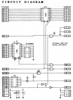

The MIF-IPC-A uses an inverter to avoid directly connecting IRQ to the bus. If I am reading the MPU programming notes correctly, the IRQ would be asserted by the PIC until the PC has read all the data that the PIC had buffered for it. It would also assert IRQ when it wants more data from the PC in intelligent mode.

You need 3 latches, ISA data write, ISA data read, and ISA command write. ISA status read is not latched, it is directly the state of the "data available for reading" and "busy handling written data" signals that are in flip-flops. You do need to buffer them though so you can enable a buffer driving these flipflop signals to ISA bus.
You don't need separate IRQ output to ISA. There is already the flip-flop holding a status that MPU data is awaiting to be read, and reading the data will clear the flip-flop and thus the pending interrupt. (Yes you might need inverting the signal or something though, but it's the same signal, isn't it? Just look at the signal chart between MPU ISA card and MPU metal box).
Input for ISA RESET line? It should be best to connect really to PIC reset, not GPIO. You really want the PIC to reset when your PC does, at least when developing PIC code and it hangs. But it may also need to clear the flip-flops to a state that both ISA and PIC think that there is no data for them and everything is ready, or the PIC could also clear these signals if possible.
Also, do the latch strobe signals really need to generate an interrupt in the PIC? It is a nice add on though. I was just thinking the PIC could sit in a tight main loop and poll stuff from ISA, as the ISA bus won't have any overruns. The MIDI uart on the other hand can't be polled unless you guarantee you poll it at over 3125 Hz rate as that is the max rate you get bytes on the wire. But this is something I just wanted to ask, I am not saying whether it should or should not use PIC interrupts.

By the way, here is the schematic of the MIF-IPC-A. Basically I'm thinking, with this design, hook all the signals on the right to the PIC.

Another crazy idea, just throwing it out there. If the processing requirements become too much for a PIC to handle, what do you guys think of splitting the functions into two PIC chips: One to handle I/O (and therefore can do UART mode by itself), and one to do intelligent mode functions? The two can communicate via a fast protocol like I2C to exchange information, and the I/O PIC can buffer messages while the intelligent PIC is busy doing other things.
