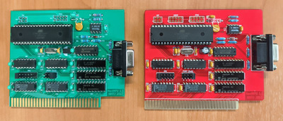

Reply 556 of 608, by ab0tj
Jager wrote on 2021-07-19, 20:56:
That "reset problem" probably needs only slight delay on reset pulse. I had 2 HardMPU boards with different capacitors - this was enough for one to work reliably, while other was glitchy.
Hm, ok. Which capacitor? There isn't a RC delay on the reset line as the reset signal comes from the ISA bus, so now I'm interested 😁
Reply 557 of 608, by Jager
All components are identical, except for 100nF ceramic capacitors (murata vs generic chinese), electrolytic capacitor (22uF polymer vs 47uF low-esr) & slightly different board.

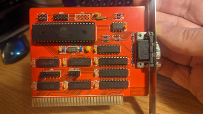

Reply 559 of 608, by Dusko
Jager wrote on 2021-07-20, 21:00:
Hi Jager, I was one of the guys that reported the "reset problem", it was only when using a Biostar motherboard 8433uud-a, the other motherboards I tested worked just fine with the HardMPU.
The slight difference in the HardMPU boards could be where the difference is, but I don't know.
So the green board is the one that doesn't have the problem, correct?
Here is a picture of mine, it has a 33uF cap.
    693.87 KiB
    1583 views
