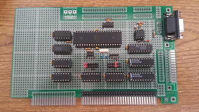

Prototype almost done... More testing after it's fully wired.

Reply 82 of 608, by dogchainx
Love it.
Reply 83 of 608, by ab0tj
Prototype all finished up. Now back to software debugging.

In other news, the git repo has been updated with a software version that does not have the hanging notes bug. More testing will be done to verify all intelligent mode functions are working correctly. If so, I'll start on making delayed SysEx and the other nice little SoftMPU features work. Basically, I just have to work out a way to turn the features on and off. I'm thinking I will find some unused MPU401 commands and use a small DOS program to send them to the board to enable or disable features.

I seem to be having trouble with large SysEx transfers, such as when King's Quest V loads the custom sounds into the MT-32. No errors are displayed on the MT-32, but it sounds like the SysEx is not taking effect. So, still continuing with the debugging. On the bright side, King's Quest IV works great.

Reply 99 of 608, by ab0tj
philscomputerlab wrote:
I'm curious what computer you are using to test games?
It's a K6-III+ machine. Using SetMul to slow things down doesn't really change anything. I'm pretty sure it's due to a problem in the code, as skipping the function that looks at the MIDI data being sent to keep track of SysEx, etc, and just sending the byte straight out the MIDI port works fine. Though, that function is exactly the same as what is used in SoftMPU as far as I can tell, and SoftMPU works fine for KQ V.
