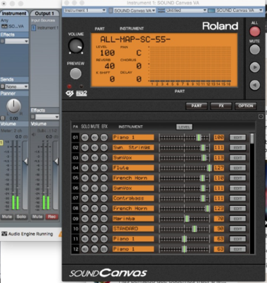

Nagra wrote:
Falcosoft wrote:
Unfortunately I'm not a Mac user so I cannot help with OSX/Garageband setup.?
Thanks for your reply. Maybe somebody else can provide me with a step-by-step-manual?
Jo
Finally got this one (partially) working after taking a break and coming back to it a couple months later. I came across this post from 2011: How-to: OS X + soundfonts + DosBox - FluidSynth , which makes mention of AU Lab. While some of the instructions need to be modified slightly, the method works, and I've gotten around the initial struggle of Garageband not "listening" to MIDI channels other than 1. Granted this is likely my inexperience with Garageband, loading the SC VA AU/VST in AU Lab worked out for me. The minor issue experienced was the plugin not allowing any UI input (mouse clicks, etc.) so I was able to get around that by loading SC VA in Garageband and saving a preset. The preset can then be loaded in AU Lab. The remaining issue I see is SC VA loaded in AU Lab does not seem to display any confirmation of the MIDI tracks actually playing. As seen in the attached image, the instruments change but there is no activity on the monitor. Not the worst thing, but it would be great if everything worked as desired.
Using SOUND Canvas VA 1.11(s) [Roland cloud version]
Latest Mac OS
    409.49 KiB
    5325 views
    AU Lab SC VA
