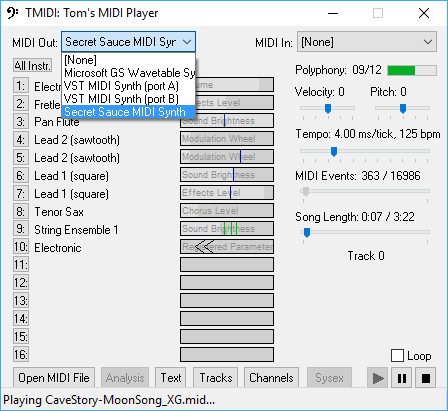

Reply 378 of 744, by kode54
I don't see why it would be for x64 systems only, it's a 32 bit binary. Of course, I may not have taken the precaution of building it for Windows XP. It's easy enough to rebuild, as long as you've got either Visual Studio or mingw-w64.
E: Here's a sneak peek at something I've cooked up:
7.77 KiB
