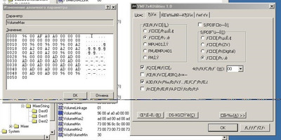

Reply 226 of 281, by vorob
Crackling may be caused by too high maximum volume. Sometimes it's because driver allows to set the volume too high, when it was taken from another card. With VxD drivers you may fix it in registry: HKEY_LOCAL_MACHINE\Software\YAMAHA\Driver\YMF724\VolumeMax, or by YMF7x4Utilities.
Sorry, but I fail to do further steps. What do I need to change in the registry to have a lower max sound or what should I press in this Japanese program? Thanks.
112.6 KiB
1098 views
