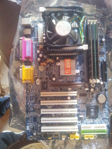

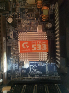

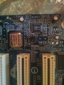

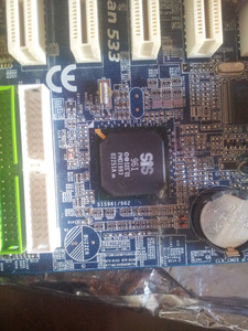

found another board that propably have pc-pci although it says sur cen instead of pc-pci. its a gigabyte p4 titan 533
No, it's not SB-Link and has absolutely different pinout.

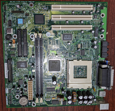

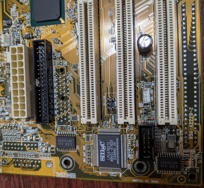

Reply 97 of 128, by cyclone3d

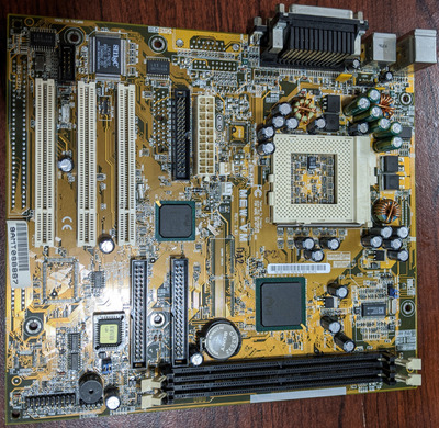

Going through my boards I found a couple i810 boards that I will be getting rid of that have the PC/PCI / SB-Link header.
1. ASUS MEW-VM - HP OEM board
675.23 KiB
2403 views
587.89 KiB
2403 views

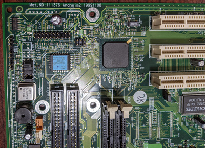

2. Anaheim2 - This one was made for eMachines, but from what I could find it was an OEM board that was used in a bunch of differently branded computers.
625.85 KiB
2403 views
716.66 KiB
2403 views
SUR CEN is most likely a header to connect a breakout cable for stereo surround and mono center audio channels.
