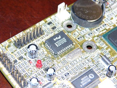

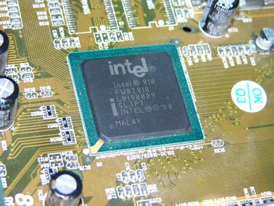

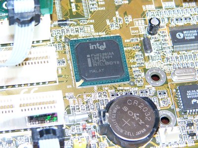

That's very kind of you, thank you. Here are photos of the three Intel ICs on the mobo. If you need photos of anything else, please let me know.

By the S-Specs of the ICs
The northbridge with the S-Spec SL3P7 and part number: FW82810, is the plain i810
The Southbridge with the S-Spec SL3MA and part number: 82801AA, is the original ICH1
The other chip is likely the CMOS

Yes, it's the original i810 chipset, with ICH southbridge. Let me check a few things.
(edit) Hm, the original setupds.exe from package 3.16 found here http://www.yamaha.co.jp/english/product/lsi/download/ DOES have the PCI ID of the ICH southbridge. It should work unmodified on your motherboard. Are you sure you're using 3.16? If not download it from the link above (direct link: http://download.yamaha.com/file/46447 ) and give it a go. It should work. But only if all other conditions are met (SB-link cable installed etc)
Also try editing the file ds.ini to reflect the IRQ that your card actually gets assigned by the BIOS.
