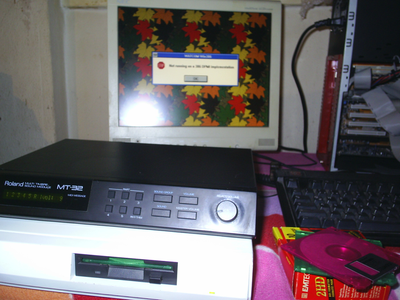

Reply 5 of 13, by Jo22
Uhm, I do have a MT-32, aswell.. I could try it on a 286 with a SB 2.0 if that helps.
Edit: Just tried, but I'm out of luck. Tried to run install.exe (calls setup.exe), but Windows mentioned an exception error at 0001:5A18.
When I ran miclog_p.exe directly, I got a second error message from the Watcom runtime (Win386).
Apparently, this program has too high requirements and doesn't work on my rig..
chrisNova777, I wish you the very best with this project and hope someone else with a MT32 will take over.
I wished I could build another 386/486 PC for testing, but my room is so crowed, I almost can't walk anymore..
(The PC in the background is a 586 class machine. Maybe I will test it there again in a few days..)

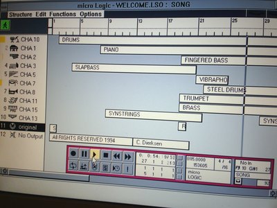

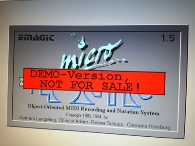

Reply 6 of 13, by Jo22
Good news!
I tried it again with my 586 machine and it worked. 😀

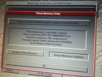

To be on the safe side, I disabled the caches first and installed the program afterwards.
Then I also disabled virtual memory, as suggested by the setup prgram.

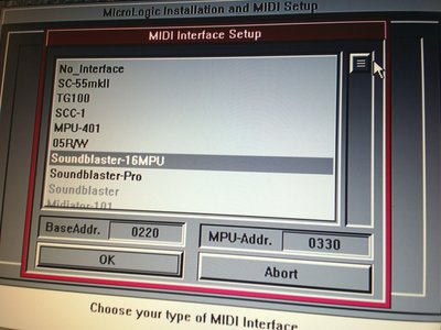

Instead of MPU-401, I selected the MIDI driver for the SB Pro DSP (not supported by DOSBox).
Doing so made things a lot more stable - the program nolonger crashed my machine.
I also did a little recording for you.
But please think of it more as a proof of the program beeing working..
I was only able to capture the left channel, because my second mono to RCA adapter is missing. 🙁
Hope that's not so bad now. The Software mentions GM Midi, so perhaps it's good to try another synth anyway.

    microLogic splash screen

    Choosing one of microLogic's MIDI drivers (MircoLogicSetup)
    255.56 KiB
    2135 views
    Virtual Memory settings (MircoLogicSetup)

    micro Logic - main window with welcome song loaded

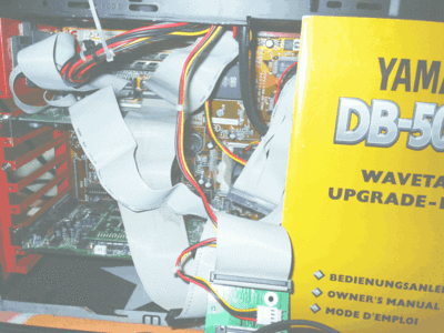

Reply 7 of 13, by Jo22
Hello again,
I installed my DB50XG and did a few recordings for you..
They aren't the best I'm afraid, but they are better than nothing, I guess.
I also tried to switch to MT32 compatible mode by playing the db50xg-bank127-mt32.mid file.
However, I didn't hear a notable difference, so perhaps playmid wasn't able to send the
SysEx commands to the MPU-401 at port 330 (it doesn't support SB MIDI, does it ?)..
I still hope that someone else with a better equipment will take over and do some recordings
with the MT-32 -or even better- the LAPC-I..

    DB50XG on CT1740

Reply 9 of 13, by NJRoadfan
See here for why this demo doesn't run on a Pentium: http://www.os2museum.com/wp/watcom-win386/
Hint: Its a speed sensitive library, that was eventually patched.
