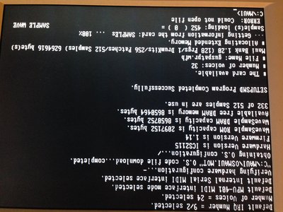

Reply 20 of 104, by FGB
Btw this is the error when I load the GUS soundbank conversion. Before the error occurs it lists and loads all the samples up to the mentioned number.
1.62 MiB
1920 views
Error
So it is missing sample # 452 but when I open the WFB soundbank with AWAVE it reports only 321 samples and I can't figure out which sample is missing. That's strange.
www.AmoRetro.de Visit my huge hardware gallery with many historic items from 16MHz 286 to 1000MHz Slot A. Includes more than 80 soundcards and a growing Wavetable Recording section with more than 300 recordings.

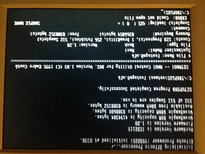

Reply 29 of 104, by FGB
Thanks for your work, bristlehog!
I tested the FANTA 8GM.WFB on the Troplus with both SETWF and SETMAUI and both result in the same error as described before, but this time it stops loading at sample # 425. Very strange!
To rule out the possibility that anything is running out the cards sample RAM I tried the converted Chaos 2MB soundbank which resulted in the same error, this time at sample # 144. The Anson Lam's 512KB soundbank fails at sample 101. Arrrgh 🙁
See the below picture of SETMAUI:
2.08 MiB
1862 views
SETMAUI ERROR: Could not open file..
I also switched between 24 and 32 voices with no difference. At one point the Tools stop loading the soundbank.
Maybe its worth mentioning that any soundbank reports 128Prgs/1 Drumkits/256 Patches and 512 Samples). Maybe, just maybe the WFB format expects 512 Samples to be present.

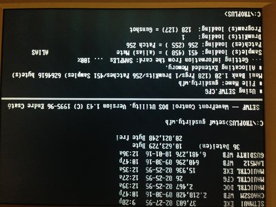

Reply 34 of 104, by FGB
Thanks! I will. just waiting for the result of the 512KB bank.. still loading.. 😉
//edit: 512KB bank still failed after loading all the samples.. still couldn't find sample #101.
//edit2: Well bristlehog: YES MAN! Thanks a lot! Loading completed! Midis soundend all right in GSPLAY! (did skip through a few standard midis. descent sounds odd but I remember it sounding off also with the GUS.. The whole bank sounds like a GUS with effects processor! Of course quite similar to the original patches of the Tropez+, but that was expected. I think that was the first huge milestone in our project - finally a working converted soundbank!
Screen attached below - This time it reported 451 samples and not 512. What exactly did you do and can it be done in a batch to all of your .SF2s?
1.86 MiB
1847 views
SETWF loaded the GUS 4MB soundbank converted by bristlehog!
Reply 35 of 104, by bristlehog
I just changed the number of samples in WFB header to a number of samples actually present there (451, judging by the fact that sample #452 failed to load).
Number of samples is a word value located at 48h offset. So, I changed 200h (512) to 1C3h (451) and here we are. I don't yet think this can be applied in a batch since I can't figure how to determine actual number of samples in a WFB bank apart from trying to load it and receive an error at (n+1)th sample. However, we might tackle it later. For now, we can [probably] quickfix any Awave-made WFB bank by putting the right number of samples into WFB header manually instead of omnipresent 512.
I'm not even sure that such a fix won't break anything. We've got to experiment more.
