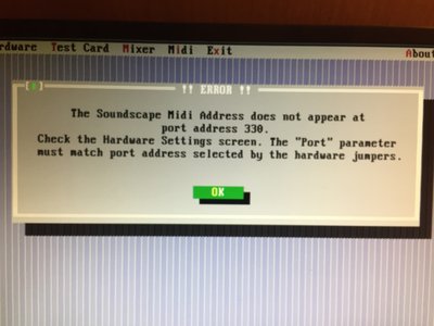

I'm in the process of building a 486 for the sole purpose of playing some old DOS games I enjoyed back in the 80-90s. I've based it on the infamous M912 VLB motherboard (mine has real L2 cache) with an 486DX4-100 WriteBack CPU, and Western Digital VLB video board. One key ingredient it's been missing is my favorite ISA sound card, the Ensoniq Soundscape. I was especially proud to run a Soundscape Elite back in the 90s since I live close to where they were headquartered in Malvern, Pennsylvania.
To hold me over while I struggle to find one, I purchased the easier to find OEM "Opus" flavor on Ebay thinking it should do the trick for now. Unfortunately, it seems that without Plug n Play BIOS support it's a no-go. In brief, to try and get it working I downloaded the Soundscape DOS driver ZIP from the Vogons drivers archives, configured the windows.ini and soundscape.ini files to match what I believe to be the correct settings for an Opus including specifying the sndscape.co3 "codefile", but SSINIT refuses to acknowledge the presence of the card.
I assume if I had used a motherboard with PnP support it would assign the necessary resources and everything would work fine.
I've attached a picture of the error, SSINIT claims it doesn't see the card at the port I've configured it for. Since the BIOS isn't configuring the card for me, I'm pretty sure that's the problem...
My question is, considering this is a DOS-only machine, is anyone aware of some kind of Plug n Play BIOS extension or utility I can run that will configure the card at boot-up, similar to the way Creative's CTCU tool does for their PnP Sound Blasters? Or better yet, did Ensoniq create their own similar tool that I have somehow overlooked?

Hi FesterBlatz (SQ3 YEA!), I did a little digging around for you and found this useful guide for your card/problem. http://permalink.gmane.org/gmane.comp.emulato … s.general/16030
I don't have any particular experience with this card, but I also had a similar problem with a SB16 Pnp (partly PnP as still required Jumpers to be changed), from what I've read the Opus has a couple of Address Jumpers on the board too. The guide by John Hupp describes the process of using SSINIT to test the hardware addresses and the states of the jumpers.

Unfortunately the problem turned out to be a damaged card. I noticed whenever I had it installed my system would become really unstable, and after looking the card over a little better I discovered at least a dozen pins on the OPUS chip were actually popped free from their pads and the whole chip shifted over a fraction of a mm. There were also a few loose pins on the DRAM chips next toe the OPUS. I think the PCB had been twisted pretty severely at one point to cause all those pins to come loose. I carefully re-flowed the OPUS, DRAM, Patch ROM, and 68000 MCU which got the card to initialize and work somewhat, but the wave-table output sounded really garbled especially when emulating MT-32. Space Quest 3 and Heros Quest (QFG1) used to sound awesome on my old Soundscape...not at all like this thing did. So I pushed my luck a little harder and tried re-flowing the OPUS pins once more but now the card fails to initialize again....so I think it's done for.
