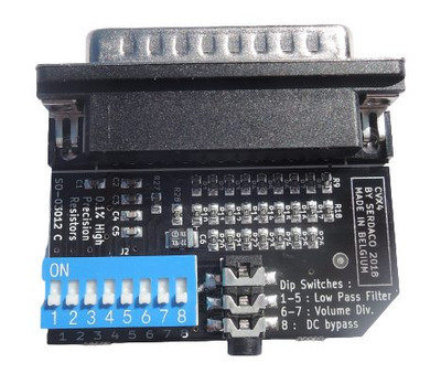

Reply 466 of 484, by dreamblaster
it sounds and works well as it is... so in the end,
I made a new batch of CVX4, Vogons Tuning Edition...
Available now again at https://www.serdashop.com/CVX4
    39.67 KiB
    1823 views
Thanks for your support !

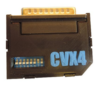

Reply 468 of 484, by dreamblaster
the new black/blue printed enclosures arrived
also I bumped into this video : MP3 playback under dos, using CVX4 : https://youtu.be/d46nYXDt4xE
    22 KiB
    1765 views
