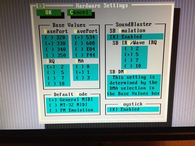

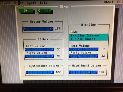

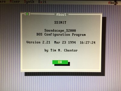

Reply 21 of 46, by FesterBlatz
I had a chance to quickly test this morning and it works great with my S-2000! It's basically identical to the version boxpressed shared for SC600/Type 1 Media FX, but without the tone control features.
You can see the S-2000 version was compiled just a few minutes before the SC600/SPEA build.
Personally, I think the MT32 emulation sounds a little better with these older versions...but I haven't had much time to really compare yet. I'll test with a few MT32 games tonight to makes sure it's not just my imagination. 😀
So thanks again for uploading this! Would it be possible to add both the S-2000 and SPEA/Reveal versions of these origonal drivers to Vogon's Soundscape driver archive page? If you'd like I could provide zips of my SNDSCAPE and MEDIAFX directories as well, to spare some folks from needing to use windows if they'd prefer that as an option too...

Reply 22 of 46, by boxpressed
Cool, I'm glad you had a chance to test because I haven't yet. So, with this v 2.21 driver, in the Quick Menu (the one that appears first that neither of us took a picture of), when you select MT-32, are you taken to another menu that then asks if you want to save the settings and/or make them default? And then do you actually see the names/filenames of the patches being loaded quickly in succession?
I have a feeling that the MT-32 emulation is a little better too. I was able to grab a sample of Gods with my SC600 when I tested last week. I'll add the link to my wavetable thread: My Wavetable Sample Thread
EDIT: Just did a quick comparison. Compared to the S-2000 with the newer driver, the SC600 does seem to have better balance with Gods (compare that tinkling noise at the beginning).
Reply 23 of 46, by boxpressed
Also, if you get a chance, FesterBlatz, could you compare the dates/times of the SNDSCAPE.COD files for the SC600 and the Gateway S-2000 installations?
Reply 24 of 46, by FesterBlatz
I totally forgot to get a picture of that page! Yes, it behaves exactly as you describe.
It's likely the SC600 MT-32 emulation sounded better because of the code file/patch difference. I bet if you used the newer drivers from that FTP site I mentioned above, it would sound identical to an S-2000 running the newer drivers too.... My hunch is Ensoniq sacrificed some sophistication of their MT-32 emulation to make room in the code file for improved Sound Blaster emulation instead...
Sure, I'll compare the date and times of the code files this evening and report back!

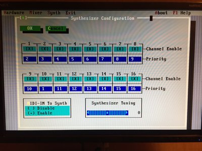

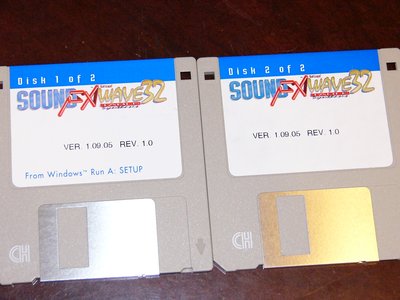

Reply 25 of 46, by Predator99
I took the chance and played with my working V7 Media fx and was really surprised to get it running in my 80286. Even the MT32 emulation works! I had expected the drivers require a 80386 at least...
However I had several difficulties I like to share.
My 80286 needs a /machine:13 parameter to get himem.sys running (this also took my hours to find out as the PC crashes without /machine:13...). So this board seems to be somehow special...
The ssinit never complained about any conflict and initializes the card properly. However, when trying dmtest.exe, during the sample test only loud noise came out of the speaker... I tried different IO/IQR/DMA without success and removed all other cards in the PC.
The solution was simply removing the himem.sys!!! Without himem.sys there is no noise and I can hear the sound...took me hours to find out 🙁
Then there was another issue with the error message "midi port not detected" in the MIDI part of the dmtest.exe. This could be simply solved with selcting another IRQ.
Last but no least the MT32 emulation does not work with another port as 330, but this should be straightforward.
Summarized, this seems to be the perfect card for my 80286, I did not expect to get MT32 sound emulated by a card here...are there any other card that can do this? 😀

Reply 30 of 46, by boxpressed
Change log is very interesting. My Reveal SC600 disks indicate version 1.09.05, which isn't mentioned in the change log. Definitely later than swaaye's Gateway drivers, however.
931.95 KiB
664 views
