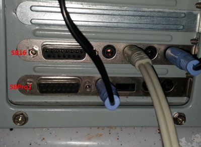

Loop from SBPro2 Speaker-out to SB16 Line-In and SB16 line-out to your speakers.

For a dual SB16 & SBPro2 configuration with the SBPro2 as the main card I set as following:
The SB16 is at A240 I5 D0, and the SBPro2 is at A220 I7 D1.
If the SB16 is of PnP kind it should be loaded first in autoexec.bat, then the SBpro2.
SET BLASTER=A240 I5 D0 H5 P330 T6
C:\SB_16\DIGNOSE.EXE /S
C:\SB_16\MIXER /P /Q
SET BLASTER=A220 I7 D1 T4
C:\SB_PRO\SBP-SET.EXE /Q /DNFI:ON /M:15 /VOC:15 /FM:15 /X:0 /LINE:0 /CD:0
To set the SB16 mixer you first have to run the SET BLASTER=A240 I5 D0 command before executing the mixer program, because the last one was for the SBPro2.
The mixer program reads the BLASTER environment variable.

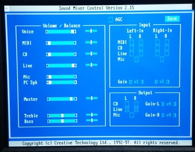

SB16 mixer settings as following:
118.42 KiB
1061 views
Voice is at max.

Line is max to receive the SBPro2 signal.
Master is one click below max to prevent distortion.
Output gain at x4 and only for Line.
Disable everything in the Input tab including AGC.
SAVE this mixer configuration because this will be your main preset the will be run from autoexec.bat.
If you want to change the mixer to something else, just do it without clicking Save.
*note the BLASTER variable before running the mixer.
When done with the SB16 mixer return to SBPro2 BLASTER (220 7 1) variable.
I keep a few batch files with the BLASTER commands if a want to adjust the SB16 mixer and back to SBPro2.
When I want to hear the SB16 MIDI/OPL/FM I just pull the loop cable out from the SBPro2.
To adjust the SBPro2 volume to exactly match the SB16 volume I use DOS MPXPlay and a 440Hz sine wave test tone and adjust the SBpro wheel, while looking an a recording meter in my recording PC to witch I send the SB16 line-out.
Yes, here too you need to set the BLASTER variable first before running MPXPlay for the same reason as the SB16 Mixer.
But, you can do the balance between SBPro2 and SB16 by ear with your favorite game, make sure not to clip the line-in of the SB16 with too high output from the SBPro2.
There you go, hope you have a strong heart and huge patience. 😎
