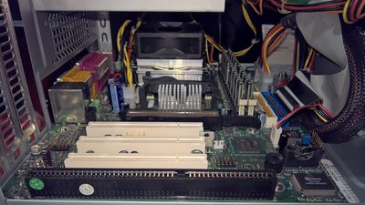

I got an nice little mATX socket 478 motherboard last year and its an Intel D845WR with AGP, 3 PCI and one ISA slot. It supports 2GB DDR ram and max fsb is 400mhz. Bios options are rather limited so advanced adjustments is not possible. This board i cant find any reference and downloads for so it was probaly an OEM make, but it use the same drivers as other Intel D845 models. Here when i installed it in a Silverstone Sugo case with a Northwood 2.8 ghz.
449.97 KiB
2274 views
To the lower right its a Winbond W83626F PCI to ISA bridge chip and i wonder if that not support ISA soundcards. Installed Windows 7 x86 and Windows 98SE with dualboot and the onboard ADI Soundmax works ok in both OS.
Have installed some ISA soundcards, but get no sound in Windows 98. I can hear some clicking noises when there should be sound. Tried Audician 32, Soundblaster Pro 2, Soundblaster AWE32 and 64, ESS Audiodrive ES1688 and some Crystal card, but no luck. I have concluded that this board doesnt support ISA soundcards. Should i try more or just give up?

Another thing i found about the Winbond W83626F bridge chip is that it doesnt support ISA busmaster. Do soundcards use that?
Yes, you're spot on, that's why it won't work. Every ISA sound card I know about at least needs DMA.

Thank you for making this more clear. So then i go in hardware properties in Winows 98 SE and see a DMA like 1 or 3 is allocated to an ISA soundcard, that wouldnt have any effect? Could not understand why it wouldnt work because most cards looked fine and green in Windows, but no sound.
Is there any utility that can test/query if ISA DMA busmaster is available instead of trying a bunch of sound cards with their different DOS programs?

A lot of the 845/865 will support sound cards, but not all of them. Some just inexplicably don't even when the bridge chipset does, just because they cheaped out and didn't run the extra lines needed to the ISA slot!

I saw and tested about ten i845 and i865 boards with ISA bus. ALL OF THEM have DMA settings (PCI and ISA PnP/Legacy ISA) in BIOS setup. Please check it first. If present (and if BIOS is its own) it MUST play sound.

It's not one of those motherboards where you can use the onboard sound or a separate sound card, but not both at once, is it? If so, disable onboard sound in the BIOS and try again...
Reply 11 of 12, by Scraphoarder
I tried to disable the onboard also, but no luck with that. I have put that motherboard back in a box and will try some others i have with a different bridge chip. The reason i wanted to use the Intel D845WR was because it could fit in a nice small mATX case. Because lack of space i want one system that are capable of tripple boot Win98se, WinXP and Win7.
