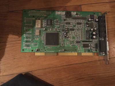

Found out a tested and workable SB CT2490 on Yahoo Auction Japan. Seems all components are soldered on it with no empty spot (except its IDE controller), I think it is the rare type of CT2940 with OPL and wanna grab it for my upcoming dos gaming rig.
But there is no clear hi-res pics displayed in its description and I've never seen a real CT2940 before, honestly I'm not quite sure about that. So could u guys give me any idea bout this card?

I'm looking at my true OPL 2940 right now (CT2943, not A2) and it looks identical. The YMF-289B-S chip is just to the right of the blue capacitor looking thing. The print on the OPL chip looks the same if you squint too. I believe the other 2940 with CQM is integrated into the main chip.
Also should mention that I have no problems with PNP or anything. You can use the card without initializing it in DOS on my SE440BX-2 system. It doesn't need diagnose; just SET BLASTER=A220 I5 D1 H5 T6. There are no jumpers on mine.

When they have the non-OPL FM chip, it's installed in that big open space directly above the main CT2502 chip.

Here is mine CT2940 with OPL3. Sorry, the photo was taken before I cleaned the card:
2.05 MiB
1317 views

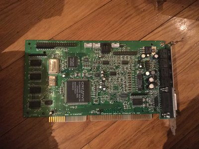

Unlike yours, it has an IDE header and chips for the controller, but you can see that the OPL chip is in the same place. Yes, it sounds great, and yes, it does have a noticeable hanging note bug. Here are two of my CQM CT2940 for comparison — you can clearly see the blue capacitor and two chips missing:
2.06 MiB
1317 views

Thank u very much for the photos uploaded!! Now I can make the final decision to get that card!
I got a roland mpu401 isa card for midi, so hanging note bug is fine for me. The only problem left is: TSR will be used for roland mpu for the intelligent mode under dos. I don't know how many dos games will be effected by the TSR....
