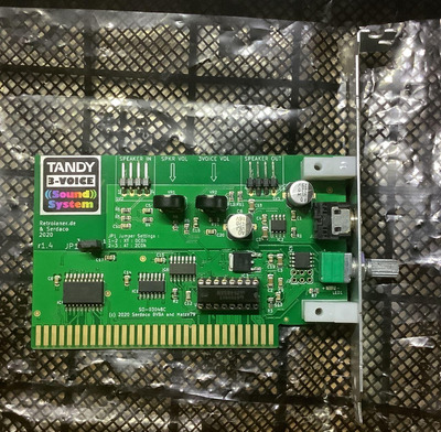

Tandy 3 Voice Soundkarte has finished now,
100.92 KiB

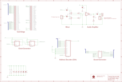

Reply 2 of 448, by matze79
yes already did contact him, does not answer anymore.
i found a old schematic.
60.24 KiB
8913 views
but i dont know if its the same version like the pcb from the store.

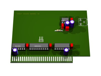

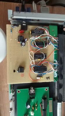

During my holidays i made some progress..
maybe soon i etch a pcb.
still need to check adress decoder, i'm never have designed one... and have no exact idea how they work.
https://shadowcircuit.de - german retro computer board

Reply 5 of 448, by matze79
Thanks 😀
111.39 KiB
8786 views
found some spare time.. need a break now 😁

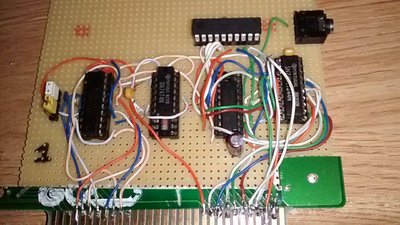

Reply 9 of 448, by matze79

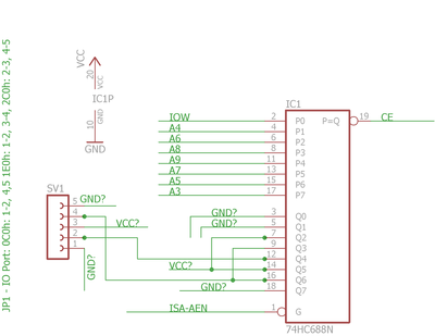

the Schematic above is really outdated, and CE never does anything with that Decoder at C0h.
I redraw something from the Pictures, James seems to use Top Plane as VCC.
As Capacitor on the Image has + connected in the top layer.
28.52 KiB
8675 views
i used the images from lotech cards i found on the net and draw this..
Maybe some one with a Card can confirm it.
My Clock Divider is working fine and also my Tandy Chip is connected right.

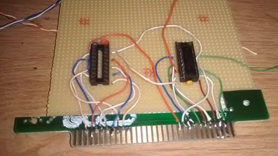

The Picture of the ISA Card (Perfboard) is wrong rewired it.
So the only remaining thing is the decoder 😀
And here my LanCable WireMess:
115.1 KiB
8674 views
Reply 10 of 448, by matze79
Adress Decoder is working now, Card is playing Sounds 😀

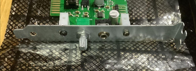

Here a Picture of the working Card:
476.42 KiB
8551 views
i working now on getting the Sound IC muted on Boot Up 😀

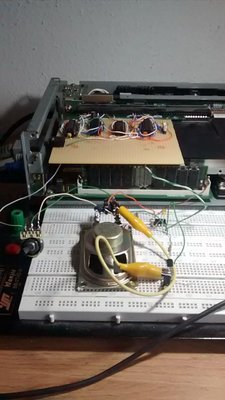

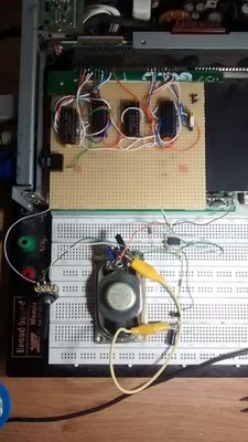

Reply 12 of 448, by matze79
breadboard test for muting 76489 successful.
Added 74HC244 to the perfboard build, allowing me to cut the 76489 from isa bus to send commands with mcu.
Had some issues, but turning down Busspeed to 4.77Mhz fixed them 😀
145.14 KiB
8529 views
Tomorrow is MCU Time 😁

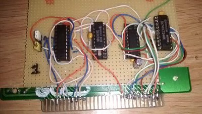

Reply 16 of 448, by matze79
106.6 KiB
8373 views
133.39 KiB
8373 views
Got it!
Muting now works.
The Card is now silent on Bootup.
A RS Flip FLop did not work well for me.
Some BIOS seem to access second DMA Controller, so running the Card on AT (0C0h) can cause the Flip Flop to Trigger on Boot..
I'm using a ATTiny13 now.
