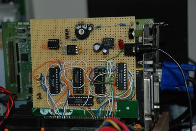

Reply 174 of 456, by matze79
all is tested, i rerouted changes and order pcb 😀

Reply 175 of 456, by Tiido
Oho, a proper prototype ! Very nice ~

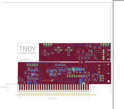

Reply 176 of 456, by matze79
Yeah its better to verify every change to ensure it will work as i wanted 😀
Current progress:
129.08 KiB
1275 views
silkscreens needs some clean up.
LM386 needs to be turned to match other ICs.
i`m testing Decoder for 0x205 now.
for IBM PS/1 3 Voice Support.

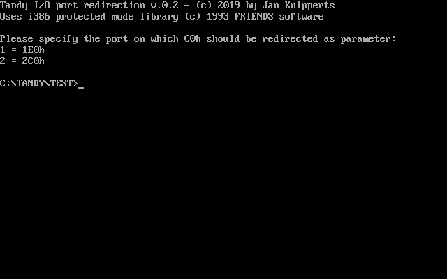

New Driver for Port Redirection without need of QEMM386 or EMM386 is in development.
