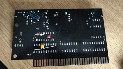

HOTFIXES for Older Cards Only, also for Tandy Lo-Tech Audio Compatible Card!!! has same bugs!:
68nf on SN76489, 2k2 Resistor on SN76489.
132.75 KiB
3033 views
If you don`t add 2k2 Resistor you will get problems running Card together with a Soundblaster or maybe some other Cards on AT.. also some bios software get stuck until mcu circuit unmutes sn76489 (AT only)
2k2 from VCC to READY on SN76489.
68pf from 7 to 9 on SN76489. -> Fixes some Noise

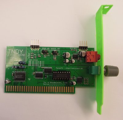

Reply 242 of 456, by root42
Finally, my kit arrived as well. Will try to assemble it and put out a video over the next week. 😀

Reply 244 of 456, by hasnopants
Got my card tested and working as well! Thank you Matze!
I got a 2nd bracket not sure if that was on purpose, but I dont think I need two. So if someone needs a spare bracket PM me.

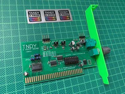

ERRATA:
The printing on the Card is wrong for Jumper Settings.
Update:
1E0h: JP2 1-2,3-4 JP1 2-3

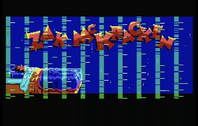

Reply 252 of 456, by root42
Good news: I assembled my TNDY board. Went relatively well. The card seems to work as well. Outputs sound, but the bad news: it induces graphical glitches and system instabilities. Did anyone else have such problems? I tried on port 0C0h, but also on 2C0h and other ports with the tndy.com port remapper.
YouTube and Bonus
Reply 253 of 456, by matze79
Anyone else also owns a ET4000 and can test this ? currently only ET3/4000 users are Reporting Issues ?!?
I tested at least 4 Machines and some playing Tunes for Days.. and had not a single Issue 😒
I also can not replicate this Problem yet.

Maybe some words here..
if you use TNDY.COM you have to expect weird Behavior because of how the TSR works.
Also its still in development.
It has the same Limitations like TEMU and VSB.
On some Machines it will work good, on others it will not.
For example, Smartdrv is incompatible and conflicts with TNDY.COM
If you have QEMM you can also try this TSR:
https://github.com/pdewacht/lotech
DragonSphere is trying to implent a Driver that does not need QEMM386 but this also has its disadvantages.
You have to expect weird Behavior if you use this Card on AT Machines configured at 0C0h,
because the Second DMA Controller is at this Address.
I did not have such Problems yet, except for Duke Nukem 3D not detecting a Soundcard correctly.
A Tandy does not have a Second DMA Controller, and later Tandys with Controller use other IO adresses.
So there is indeed some small issue but i`m sure we can rule it out.
the majority of machines seems to work just fine.
i have at least installed 4 cards for testing purposes in different systems
ranging from Nec V20 to Pentium 2.
And no one shows this glitch.
That makes it difficult to track it down without replicating the issue.
Fact is if we remove the Latch, it does no longer occur.
But on my Systems this is no issue.
Also on Dreamblasters Machine all works as intent.

Reply 259 of 456, by Tiido
