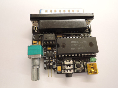

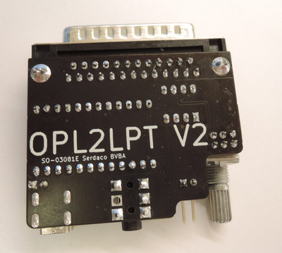

Prototyping a new version of OPL2LPT : "OPL2LPT V2"
    162.51 KiB
    1499 views
    262.25 KiB
    1499 views
Thanks for your support !
Reply 551 of 566, by matze79
Smaller footprint, so it will fit more PCs!
*Like* 😀
Reply 552 of 566, by s|ugfish
I'm using the Opl2LPT2 v2 on a lenovo m32 thin client .running free dos . I was wondering if anyone had any sugrestions to reduce the level of buzzing I'm currently encountering with it. I've tested it with an exsternal power source, and using usb power from the m32 . In both cases the volume is very low, and their is a high level of 'noise' . Initialy i thought it was a grounding loop or some crappy speakers but i've tested multiple speakers and tried swaping to an exsternal power source. Any sugestions would be much appreciated.
Reply 553 of 566, by dreamblaster
Hi,
here are some suggestions :
- press the reset button after bootup, to reinit the chip, does the noise go away ? This is needed for some pc's, depending on the bootup order and states of parallel port during this. Check parallel port settings in the bios.
- turn the pot all the way and then back to the middle. while testing opl2, the volume can go pretty loud, so if the volume of music stays low there sure is something broken.
- connect a headphone directly and listen through this ? does it sound good ?
- use an usb powerbank as power source, see if this also has the same noise.
if you cannot get it sounding good,
send me a pm or contact me through https://www.serdashop.com/Contact
I will support you in this, and send a replacement if your opl2lpt is broken

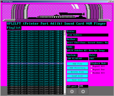

MemberA2600 let me know, he is working on a Video Game Music Player for the OPL2LPT sound card on modern Windows.
see https://github.com/MemberA2600/OPL2LPTVGMPlayer
168.07 KiB
1294 views

Ah, that's cool! Reminds me of my parallel port experiments with Win 3.x/9x and Visual Basic back then!
On Windows NT, PortTalk or Port.dll can help accessing the LPT ports.
The programs using it can still be 9x compatible, afaik.
Reply 556 of 566, by Jo22
dreamblaster wrote on 2023-01-29, 11:10:
It looks very good, there's just one minor complain, maybe: The resolution is a bit over 1024x768 (1.025×858)..
It the window was a little bit smaller, it would be compatible with LCDs from the Windows 98/XP era.
Or laptops. Some slightly older models from the 2000s do have 1024x768 screens and an LPT port.
Many of them could run Windows Vista/7, if needed, which technically is a modern Windows.
Edit: Picture added.
Edit: Ah! It's an Win64 application ?! If so, then never mind, it wouldn't run there anyway.
(I'm not entirely sure, since it doesn't run on Win XP SP3 but has an inpoutx64.dll file.)
    155.23 KiB
    1260 views
Reply 557 of 566, by MemberAtari
Jo22 wrote on 2023-01-29, 17:56:
No, it's a 32bit one. 😀 inpoutx64.dll was not working, so I had to do do it as a 32bit application. 😀
My original plan was to size it for 1024 * 768, but I run out of space on the window. 😁
Reply 558 of 566, by Jo22
MemberAtari wrote on 2023-01-29, 18:32:
