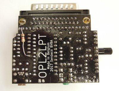

Reply 484 of 566, by 640K!enough
Paralel wrote:
To me, it sounds like it should be a revision to the board to include this resistor.
Agreed; at the very least, the design should be revised before another batch is ordered.

Reply 486 of 566, by Scali
sayjionix wrote:
today I made some analyses to find out what causes the OPL2LPT to output only distorted screechy sounds on some of my computers / IO-controllers. I think I came to an idea and an option to fix it, but not sure if this is the preferred way, so please let me know what you think.
Interesting...
I found a similar problem on my IBM 5160 and PCjr... I wrote my own VGM replayer for OPL2LPT, and initially tested it on my 286-20 and Celeron 1.5 GHz laptop. The code worked fine on both.
Then I tested on the 5160 and PCjr, and found that they only played garbage.
The way I solved it was by changing the order of the commands sent to the LPT.
Apparently the IBM printer interfaces were sensitive to this somehow. The changed code still worked fine on the other two machines.
I can build some test programs using both variations. I wonder if the issue I had was similar, and changing the commands around would somehow change something in the signals similar to the resistor you added.
Reply 487 of 566, by sayjionix
That's interesting! As it can be seen on the comparison of the Adlipt TSR and the OPL2TEST program, a small timing difference of the command lines can have impact on the result (at least if the STROBE signal is not too washed out, as it is for example on my 486). So your command sequence may have provided enough time for STROBE to rise again, before RESET toggles. But that's just a guess...

OPL2LPT easy mod : 1k pullup on strobe signal, for solving compatibility issues on PCJr and possibly other early computers
only needed if you experience problems (I could not test on my PC, as it always works, also without the mod)
196.51 KiB
2255 views
If you have PCJr or similar, and this does not solve the problem, please report in this thread
