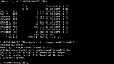

Both of these suggestions sound quite nice for sure. There is one limitation I can think of though, the patcher does not patch compressed files. You would have to also use some sort of decompression tool, I just tested out a Dos program called UNP with Wolf3D.exe and it was only after I decompressed the exe file I could patch wolf3D. I guess you could include the patcher and a decompression tool in one package for convienience. Here is the site I got the UNP program from: http://unp.bencastricum.nl/
    56.94 KiB
    2070 views
    Game finally can be patched. Yay!
